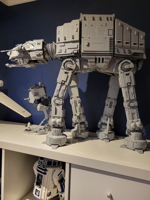

Schneeds Posted April 26, 2022 Posted April 26, 2022 (edited) About a thousand tiles later... This set is a great foundation to work on, and the stability really is worth the sacrifices. Edited April 26, 2022 by Schneeds Quote
LDigital Posted April 26, 2022 Posted April 26, 2022 Looks great. I was planning on doing something very similar but decided I liked the default look enough to keep mine stock and save some dough. Love it though Quote
Kage Goomba Posted May 1, 2022 Posted May 1, 2022 On 5/1/2022 at 1:21 PM, cheech said: Expand Gorgeous diorama - nicely done. Quote
cheech Posted May 2, 2022 Posted May 2, 2022 Thank you, not finished, the wall will be painted light blue, new white Table is on the way. Quote

GrandEmperorBinks Posted July 9, 2022 Posted July 9, 2022 On 7/8/2022 at 5:25 PM, cheech said: The front viewport sounds interesting, pictures? Expand @cheech , this is the picture he sent to me of what he had done. His explanation for the mod was as follows (paraphrased): "...all you have to do is flip the screen upside down, basically the hinge parts and anything attached to them. Then pull the wedge plates off the ends, leaving the 1x1 with bar and attached these in in its place (in Light Bluish Grey). And there is an added 2x6 plate under the 2x6 tile on the underside of the viewport." It looks pretty good imo, and I'm definitely going to be doing it! Credit to my mate known as Empire Lego in the Lego world. P.S. that display looks great mate! Well done! Quote
