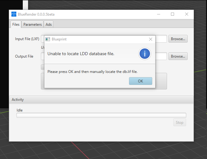

Bluerender - when I go through the files, no database come up

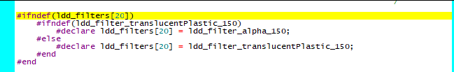

Pov ray

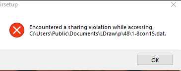

Ldraw
Also have a bunch of Ldraw setup icons that won't close. Obviously can force them, but they're just sat there

It's this line on povray that's highlighted
If I delete it, I get this error instead:
With a similar message - "ldd-default-materials.inc" line 19: Parse Error: Expected ')', [ found instead

  • It is difficult to understand LDD2Powray problems without an error log
  • did you locate manually the database as suggested in the error dialog

  • LDRAW is not exacting a LEGO digital tool, but a file format. Maybe you are trying to install the All-in-One LDRAW installer? (it includes some modelling software, tools, the LDRAW library, ...) Anyway restart your PC to close all the LDRQAW instances that could compromise the installation.

Bluerender will not work if you dont recreate the lif database in LDD. You need the lifcreator tool, and it takes quite a bit.
Probably the lack of the database creates problems with LDD2Powray too, these software has been developed before the unofficial LDD parts pack was first released.

db.lif is showing in the LDD file, but is missing when I search for it when using Bluerender

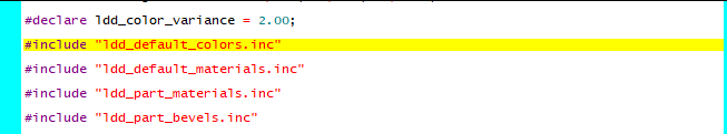

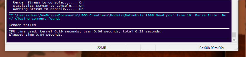

It stops at the line that says:
#include "ldd_default_colors.inc"
With the Parse error: No */ closing comment found

Without seeing all of the code it looks like somewhere earlier up there is a line that is marked as a comment, but for whatever reason the comment section never closed. That's why it's saying it couldn't find */
So it isn't executing because it thinks all of the code is a comment. Try looking through earlier lines and make sure all comments are closed (or just delete them all).
