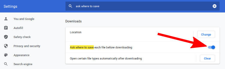

Pybricks Posted July 21, 2021 Author Posted July 21, 2021 @Mr Jos: @Lok24 is using Powered Up Hubs using our online editor. All of the newer hubs use this. These hubs are much less powerful than EV3, so they can support only one script at the time. There is no Visual Studio Code support at this time. Quote Did someone find out how to save the code with a name other than "main.py"? You can change this setting in your browser, so it will ask where to save the file and choose a name. Instead of putting everything in Downloads. Also quite useful in general. Quote Or how to import classes from local stored files like "c:\py\MyClasses.py" Powered Up hubs have limited storage and processing power, so you can have only one main script, without additional modules. Quote
Mr Jos Posted July 21, 2021 Posted July 21, 2021 2 hours ago, Pybricks said: @Mr Jos: @Lok24 is using Powered Up Hubs using our online editor. All of the newer hubs use this. These hubs are much less powerful than EV3, so they can support only one script at the time. There is no Visual Studio Code support at this time. You can change this setting in your browser, so it will ask where to save the file and choose a name. Instead of putting everything in Downloads. Also quite useful in general. Powered Up hubs have limited storage and processing power, so you can have only one main script, without additional modules. Ah alright, thanks for the info didn't know it could not be programmed with VSC. 1 more reason for me to not buy anything else then EV3's (maybe RI if I ever see the need for it as it can be programmed with VSC aswell.) On a side note; The project I'm making now, Technic pin sorter is running sometimes into a bug. The motors are switched off/on very fast if 2 pins are to close to eachother to create a gap, the acceleration is set very high for good length/color detection, only the feeding belt ramps up slowly again. 1 in 100 times you can hear the quick belt not accelerating all the way to 700°/s and hesitating, and also a 1/500 chance a feeder belt does not get turned off when the color belt does(they always get both the command at the same time). When stopping the program with the brick button, also a small chance that the feeder belt keeps running slowly even though no program is running anymore at all. Only way to stop it is start running new program. (or unplug the wire) Quote
Lok24 Posted July 21, 2021 Posted July 21, 2021 Thanks for your response, 6 hours ago, Pybricks said: You can change this setting in your browser, so it will ask where to save the file and choose a name. Instead of putting everything in Downloads. Also quite useful in general. Yes, but this is general for all downloads, which is not desired at all. I'll see if it is possible to set up different profiles (like in FF) to solve this. And when I open a file "x:\myprog.py" the download (=save) always proposes "main.py" and not "myprog.py", thats what I meant, sorry for any missunderstanding. 6 hours ago, Pybricks said: Powered Up hubs have limited storage and processing power, so you can have only one main script, without additional modules. Isnt't there something while downloading the source code to the hub to insert source code from a file? How could I use the same routines in different progs without copying them manually? That was my idea/intention. Quote
