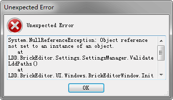

Hello, I have tried many computers, win7 or win10, most of them can't run, a warning window pops up, and the latest version of your v1.0.7.0 is used.(I don't know English very well, this is the Google translation, probably the meaning should be correct)

Is this software dead or what??? I see last post is from summer of 2022. I have downloaded Brick Studio Release v1.0.6.2 from the Github but it crashes without warning like 2 seconds after opening - why? This way it is useless on W10 x64. Isn't there some newer stable version?
EDIT:
Seems I found reason: one has to run this software as administrator, then it doesn't crash - you'd state this somewhere for all those having this kind of problem.

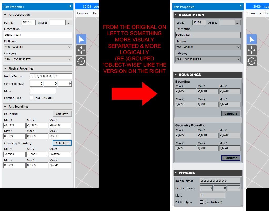

As for the name "LDD G CREATOR" would be the best name, as your actual one is in "conflict" with the Bricklink's Brick Studio. Or "LDD G-Cri8||" (the last sign is programmatical sign for "or" but you sure know as a programmer yourself)
As for the interface: it looks too clogged and it is quite hard to orient there, so I would suggest something like this - rather small but important better GUI "differentiating" (for instance physics section is the least important of those 3 sections - definitely less than boundings, thus logically it should/could be the last - one can omit it from the xml and the brick will work anyway in most cases):
Also: how in the world one creates collision box(es) in there? I cannot see any tool for that, or is it hidden somewhere? The same goes for the brick connections: I see tab for that but it is grayed and I cannot seem to find a way how to enable it. Or is there already some other more mature version of this software somewhere?
EDIT:
Ah, those are REALLY HIDDEN AS RMB CLICK(S) in/on the right side panel...why, why, why? So many "illogicality" (could not find better word, messiness maybe would be better term?) in otherwise good tool - you really do need someone for this kind of stuff, I agree with you!
I would say collision section needs its own separate panel, like the one on the left, or new section in the left panel called COLLISIONS - definitely! Or even better as to not break the GUI logic: add BUTTONS for adding collisions to the right panel!
Also as for the logicality: when one RMB clicks on the elements in the right panel the context menu should correspond only to the section one clicked on, that is if I click RMB on Surfaces only add surface option should appear, not everything. Everything should appear if one clicks on the empty section in the panel, right?
