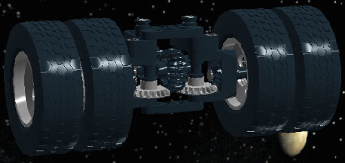

keymaker Posted May 7, 2021 Posted May 7, 2021 Start from using lighter background, then we'll talk :D Quote
howitzer Posted May 7, 2021 Posted May 7, 2021 Lighter (neutral white/gray is good) background, coloured parts (preferably in a colour they are commonly made, for example red for clutch gears) and colour-coded liftarms and other parts commonly made in many colours would be nice. Unless you're trying to show off different parts of a drivetrain or some such mechanical device, colour coding the movement pathways (for example through a gearbox) is good. Quote
syclone Posted May 7, 2021 Posted May 7, 2021 You can use Ctrl+K to take screenshots in LDD building mode (the shot will be framed as you see it). What kind of vehicle is that axle for? It is very narrow yet has double wheels with a big diameter, so nothing comes to mind. Also, the 1x4 half liftarms are most likely going to disconnect from top&bottom, so a better structural soluction would be required. Quote
Nazgarot Posted May 7, 2021 Posted May 7, 2021 I don't understand what you are attempting here. Are you building a narrow steered axle with drive that is not supposed to have suspension? Why? There would be better solutions even though this will give you a very good steering angle if you change a few tings... What is this for? Anything I can think of that needs this kind of axle is supposed to carry a very high load, hence not being suspended, but this build is far from strong enough for anything like that... The first thing that comes to mind is the axles of some heavy load transport platform, but that would be better solved by using a turntable mounted solution with a differential to allow the wheels to turn 360 degrees. Would love to hear more of what you are thinking, and if you have made any actual prototypes and stress tested them. _ED_ Quote
SUPER Max Black Posted May 8, 2021 Author Posted May 8, 2021 (edited) This axle is for excavator. Regarding the degree of rotation, I will correct it. Edited May 8, 2021 by SUPER Max Black Quote
SUPER Max Black Posted May 8, 2021 Author Posted May 8, 2021 Well, that's how it turns. This is the maximum. Quote
Nazgarot Posted May 9, 2021 Posted May 9, 2021 (edited) This seems way to narrow for a excavator, and it can't handle the stresses a excavator will expose it to. I suggest trying to build it with actual parts and stress them by applying a load similar to the expected weight of the complete build to see what I'm on about. Also you have a problem with the swing point being so far from the actual wheels. This makes the wheels move a lot in longitude rather than rotating around the wheel center. It makes for a unstable model as well as making it very hard to steer and event harder to steer while under power... I suggest you start over, and start by addressing the steering point. You should place it as close to the center of the wheel as possible, and you want to make sure the stub axle is well supported as well. Using a hub with three pins holding the wheel would be preferable when carry a big load like a excavator, but it can be solved in other ways as well. The setup you are showing in LDD is very good when you want a very large steering angle, but still has the problem of moving the wheels to much and not being stable or able to handle a high load. Ant that only advantage is hampered by the way you have linked the steering. If I can find the time I might post some suggestions for you later. For now, good luck with your excavator, and please don't give up just because the first iteration was not perfect. Making the perfect is a lot of trial and error, and in Lego you always end up with a compromise anyways... :) _ED_ EDIT: A quick mockup - Would suggest something like this. It would need some more bracing and maybe a better connection to the wheel, but gives you a much better piviot for the wheels being only a single stud away from the edge of the wheel, and is only a single stud wider than your own design. The diff should be braced with 20t gears on either side to keep it in place, and you need to ad 2x4 L beams to control the steering like you have in your own design. It is a suggested starting point. Do with it as you like, but if you have any hubs I suggest rather using those. Fore the steering angle you are trying to achieve they will do well. Edited May 9, 2021 by Nazgarot Added picture and additional coments Quote

SUPER Max Black Posted May 9, 2021 Author Posted May 9, 2021 (edited) Something like that: Edited May 9, 2021 by SUPER Max Black Quote
SUPER Max Black Posted May 9, 2021 Author Posted May 9, 2021 (edited) Who knows how to connect wires from motors? I just can't figure it out. By the way, here is the x-ray of the axis. Anyone with an idea for the steering gear (it isn't here). Edited May 9, 2021 by SUPER Max Black Quote
SUPER Max Black Posted May 9, 2021 Author Posted May 9, 2021 I'm not entirely clear on how to position the wheels correctly? Quote
syclone Posted May 9, 2021 Posted May 9, 2021 Here's the most basic setup for that axle. The wires in LDD are always "separate" from the component they belong to, there's no functionality of routing them. You simply connect the plug to whatever port you want it to use and that's all. Quote

SUPER Max Black Posted May 10, 2021 Author Posted May 10, 2021 Here is the last photo of my axis. By the way, who knows the LDraw app? Quote
syclone Posted May 10, 2021 Posted May 10, 2021 6 hours ago, SUPER Max Black said: And I would like to ask which version of LDD is better to use? 4.3.11, here's a guide on where to get it: Also, there's new parts being added on Digital tools Subforum, takes 5 minutes to setup and adds a LOT of missing parts. In regards of LDcad (LDraw is the system of file formats&tools) it has a steep learning curve but it is well worth it as it's probably the best digital building tool there is. Quote
