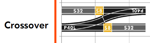

Brickblock1 Posted July 19, 2022 Posted July 19, 2022 On 7/19/2022 at 10:08 AM, crizz11 said: Just confirming, are there 8 studs in between these two parallel tracks when you use two P40L's? Also which Windows software has FX tracks in it for layout design please? thanks. Expand The the centers of the track there are 16 studs and between the edges there are 8 studs. And I use bluebrick to design my layouts but I think you have to download the fx track library from l-gauge.org Quote

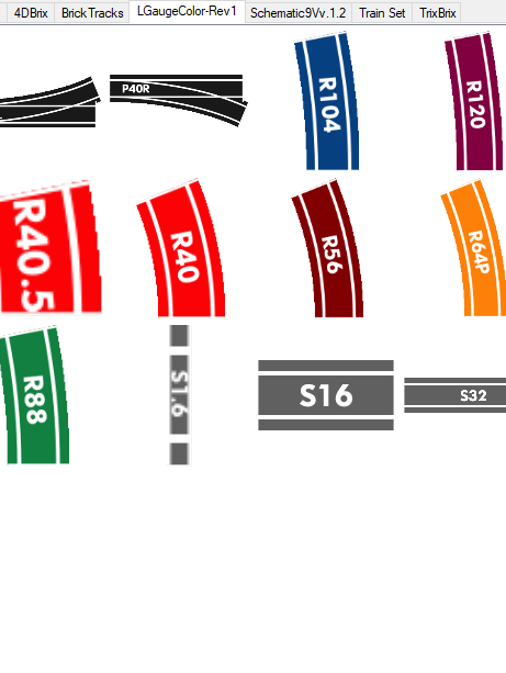

crizz11 Posted July 19, 2022 Posted July 19, 2022 On 7/19/2022 at 12:44 PM, Brickblock1 said: The the centers of the track there are 16 studs and between the edges there are 8 studs. And I use bluebrick to design my layouts but I think you have to download the fx track library from l-gauge.org Expand ok thanks mate i found the zip, i unzipped it into the parts folder under the bluebrick 1.9.1 folder, i can see the tab for FX in the application but when i click on that tab i don't see any track elements in there. Quote
Black Knight Posted July 19, 2022 Posted July 19, 2022 (edited) On 7/19/2022 at 1:17 PM, crizz11 said: ok thanks mate i found the zip, i unzipped it into the parts folder under the bluebrick 1.9.1 folder, i can see the tab for FX in the application but when i click on that tab i don't see any track elements in there. Expand Just to be sure: Did you (re-) start BlueBrick after you copied the LGaugeColor directory into the parts folder? It is only loading the libraries on startup. The tabs name should be LGaugeColor btw. Edited July 19, 2022 by Black Knight clarification Quote
crizz11 Posted July 19, 2022 Posted July 19, 2022 On 7/19/2022 at 1:33 PM, Black Knight said: Just to be sure: Did you (re-) start BlueBrick after you copied the LGaugeColor directory into the parts folder? It is only loading the libraries on startup. The tabs name should be LGaugeColor btw. Expand ok i downloaded the LGaugeColor-Rev1.zip and extracted that into the parts folder, and can see the tab in the app. Where do i extract the fx zip to though please? Quote
Black Knight Posted July 19, 2022 Posted July 19, 2022 On 7/19/2022 at 1:52 PM, crizz11 said: ok i downloaded the LGaugeColor-Rev1.zip and extracted that into the parts folder, and can see the tab in the app. Where do i extract the fx zip to though please? Expand You should end up with parts/LGaugeColor/P32L.72.gif (so all the .gif and .xml files should be in parts/LGaugeColor). Unfortunately quite many unzip-tools add some directory when extracting. The files must be in a directory exactly 1 depth below the parts directory; not two, not zero. Quote
zephyr1934 Posted July 19, 2022 Author Posted July 19, 2022 On 7/19/2022 at 10:08 AM, crizz11 said: Just confirming, are there 8 studs in between these two parallel tracks when you use two P40L's? Also which Windows software has FX tracks in it for layout design please? thanks. Expand I believe it is an 8 stud spacing for the gap, or 16 studs center to center (but verify with FX before you purchase or invest in planning). As for track planning, Bluebrick is the most common way to go. The track style used on the box art (above) is available in BB here. I believe Michael Gale (of FX) made that artwork. Elsewhere (I think on the main BB site) you can also get a wide array of TrixBrix track that includes most of the FX geometries Quote
crizz11 Posted July 19, 2022 Posted July 19, 2022 On 7/19/2022 at 2:54 PM, Black Knight said: You should end up with parts/LGaugeColor/P32L.72.gif (so all the .gif and .xml files should be in parts/LGaugeColor). Unfortunately quite many unzip-tools add some directory when extracting. The files must be in a directory exactly 1 depth below the parts directory; not two, not zero. Expand I have extracted the fx zip into the parts/LgaugeColor/ folder but i still only see like below Quote
zephyr1934 Posted July 20, 2022 Author Posted July 20, 2022 On 7/19/2022 at 9:22 PM, crizz11 said: I have extracted the fx zip into the parts/LgaugeColor/ folder but i still only see like below Expand Looks like you've got it, and you do have to scroll through the parts to find everything. See the instructions for working with bluebrick for the rest. Quote
crizz11 Posted July 20, 2022 Posted July 20, 2022 (edited) On 7/20/2022 at 2:52 PM, zephyr1934 said: Looks like you've got it, and you do have to scroll through the parts to find everything. See the instructions for working with bluebrick for the rest. Expand EDIT: I get it now and using it fine in Studio. Thanks for your help everyone. oh i thought it was meant to ALSO look like this. Or are these only for use in ldraw or studio? Edited July 20, 2022 by crizz11 Quote
zephyr1934 Posted July 21, 2022 Author Posted July 21, 2022 On 7/20/2022 at 9:01 PM, crizz11 said: oh i thought it was meant to ALSO look like this. Or are these only for use in ldraw or studio? Expand I think those are only for LDraw based programs (including studio) Quote
