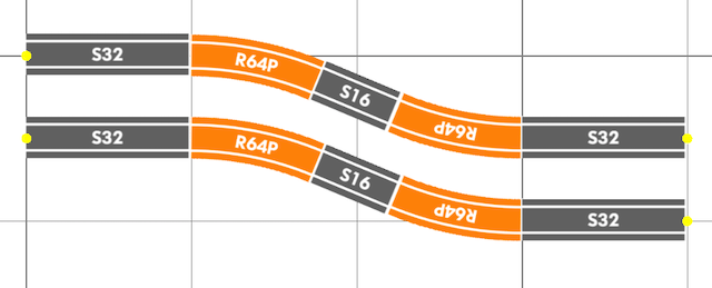

Sunil766 Posted March 24, 2021 Posted March 24, 2021 On 3/23/2021 at 4:43 PM, michaelgale said: @Wimmer(can't remove this on the phone) However, since our P40 switch terminates at (+8.0 / 0.0) at a diverging angle of 22.62 deg, a perfect return curve can be made with S8 straight element and R64 curve element (with 22.62 sector angle). It is not just close, but mathematically perfect. Expand Quote

Ashi Valkoinen Posted March 26, 2021 Posted March 26, 2021 On 3/26/2021 at 6:59 AM, Black Knight said: Isn't it obvious? Just buy 8 kits and have one of those very, very exclusive R64 circles! Expand No, it won't work, since R64 curves turn 22,62° instead of 22,5°. Quote
michaelgale Posted March 26, 2021 Posted March 26, 2021 @Duq Honestly, we don't know what the retail price will be for the switch kit yet. I guess all I can say is that it will be expensive :( The development costs are pretty big. However, it will not be out of line compared with model train switches in the biggest scales. @Duq, @Black Knight, @Ashi Valkoinen Don't forget, there is one nice use for the "leftover" R64P curves: short and grid aligned S-bends! Quote
zephyr1934 Posted March 28, 2021 Author Posted March 28, 2021 On 3/26/2021 at 3:49 PM, michaelgale said: @Duq, @Black Knight, @Ashi Valkoinen Don't forget, there is one nice use for the "leftover" R64P curves: short and grid aligned S-bends! Expand That's nice Quote
