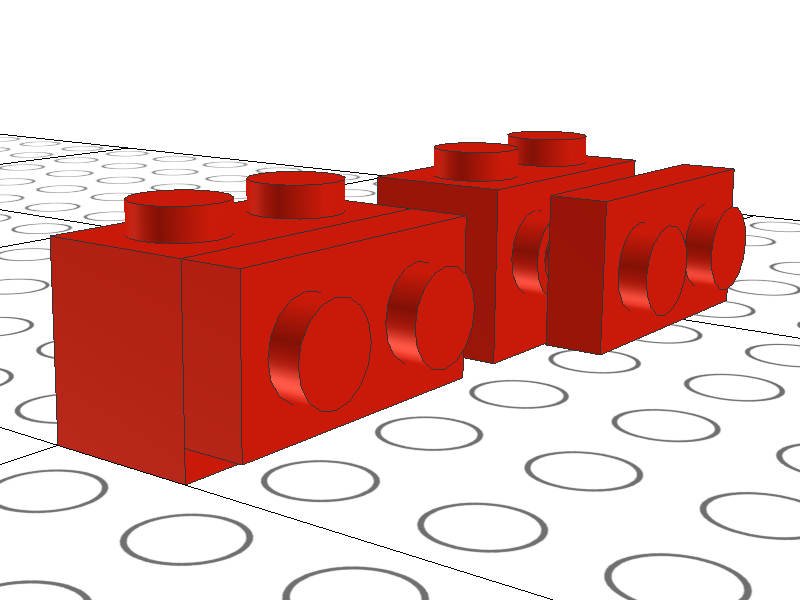

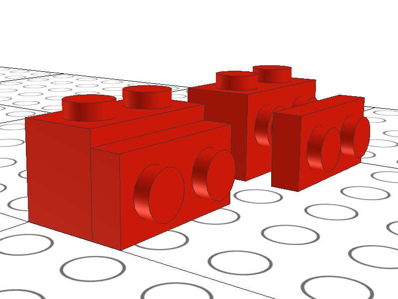

mEan Posted January 13, 2021 Author Posted January 13, 2021 I am struggling with the Pop-Up book-like design, because unlike the book, I want to have plates instead of brick wall on sides, so I need to figure out how to attach hinges to these plates. But every SNOT technique I can think of deals with a problem with the hinge plate being placed on top of side of a brick, creating a 1 stud width (8 mm) vercital gap, which I cannot compensate by brick height: Is there a SNOT technique which alows placing the plate aligned to the bottom of a brick? Like this: Quote
