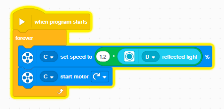

Munchkin255 Posted December 15, 2020 Posted December 15, 2020 I made this program in Scratch for Spike Prime, and it works as intended. The motor is stopped when there is no reflected light and moves at full speed, when the light sensor is measuring against a white piece of paper. The value of reflected light is meassured in percent, with a range from 0 til 100. In order to do some math and to provoke a non-integer value for the power setting I use a muliply by 1.2 math block. There isn't any start motor at power block, instead power is set before staring the motor. Cheers Carsten Quote
biasedlogic Posted December 16, 2020 Author Posted December 16, 2020 Thanks for testing it out, in Classroom the line with setting the speed gets ignored. If the line "start motor clockwise" is present, it will run at constant, full (?) speed, if it's absent, the motor will remain stationary Quote
