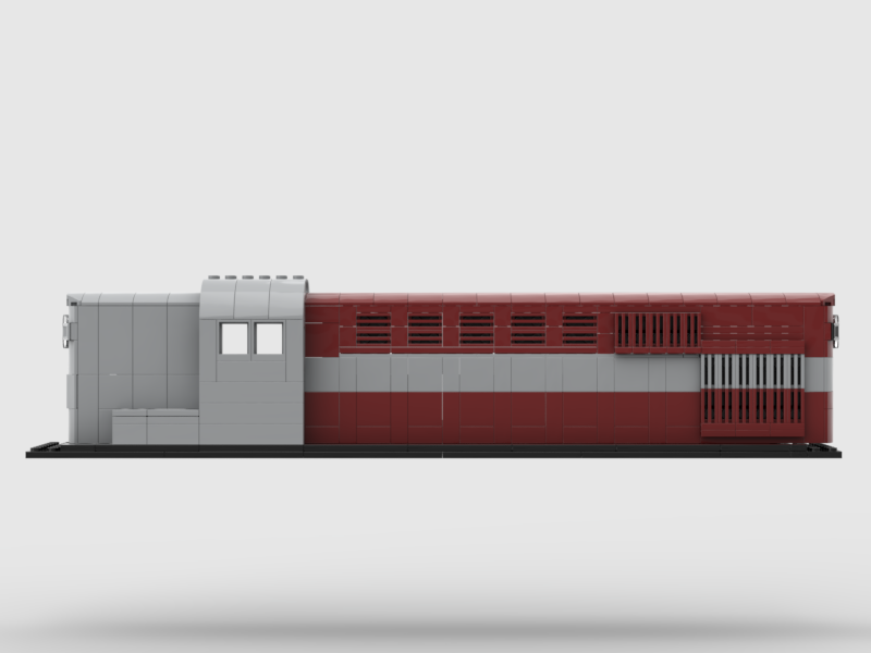

Supplement_Creatif Posted October 20, 2020 Posted October 20, 2020 (edited) Hello there, First time poster here, thought I would share a build to get some advice and feedback from others. If anybody here happens to be one of my 6 followers on instagram (that which I highly doubt, as one of those followers happens to be myself as well), you would know that I have been working on a GE 44-Ton locomotive of the Greater Winnipeg Water District. A really cool short line (I believe is what they are called) railway with a very cool, although controversial, history. The 44-ton being such a small loco, I was having trouble nailing the details I wanted to get. Along with part colour availability that had left me frustrated. Also I couldn't even imagine getting power functions in this thing its so small (most likely necessitating a powered freight car to run a train with the 44-ton at its head). Anywho reading the new Brick Model Rail Roader article on scaling I took away quite a few things. Most importantly that since we have the luxury of modeling with Lego, we can come back to stuff and modify it at anytime we desire! I therefore decided to take a break with the GWWD short line project and do something a bit bigger allowing me a greater canvas to experiment with detailing and also put some power in it. I am definitely not shelving the 44-ton switcher, just need some time away from it to get a fresh outlook and maybe learn some building techniques before going back. So on to the actual post! A MLW RS-18 in Canadian Pacific colour scheme. I was looking for a new project (see lengthy preambule) and found a few threads on here. First thought was to make an RS-23 locomotive as the GWWD has quite a few in its roster included two in CP action red paint as spare parts for their working ones. Looking at the forum I saw SteamSewnEmpire's thread about an RS-23 and loved it! Somehow though I stumbled upon SteamSewnEmpire's RS-18 loco and though: wow that is a sweet locomotive! Looking at prototypical photos online of the RS-18 I decided let's do it why not! So here it is, first WIP photo. Will be posting more angles once I get a better handle on how to put pictures in a post. Any and all feedback is more than welcomed! cheers! And lastly here is a photo of the prototype locomotive. The one I am modeling is the top left, numbered: 8786 Edited October 20, 2020 by Supplement_Creatif Quote

ivanlan9 Posted October 20, 2020 Posted October 20, 2020 (edited) Long time Alco fan here. To me, the proportions look really good, but the square grills on the sides look too big. Could you use the backs of headlight bricks for this purpose, perhaps? Metta, Ivan Edited October 20, 2020 by ivanlan9 Quote
zephyr1934 Posted October 21, 2020 Posted October 21, 2020 Definitely a good start and I don't see much to tweak from the profile view except perhaps replace the studs on the cab roof with tiles and extend the deck for the rear runningboards. If you build PF or PUP is there room to hide the battery box and receiver? Quote
Supplement_Creatif Posted October 21, 2020 Author Posted October 21, 2020 Thanks for the Replies so far, very much appreciate the feedback! 16 hours ago, SteamSewnEmpire said: Nice. Did I do one of these? I cannot honestly remember. If you need any assistance, let me know. I will definitely shoot you a line if I ever want to dig deeper in the model you made! 16 hours ago, ivanlan9 said: Long time Alco fan here. To me, the proportions look really good, but the square grills on the sides look too big. Could you use the backs of headlight bricks for this purpose, perhaps? Hi Ivan, I was able to find mechanical drawings for the RS-18 and those side grills are a tad oversized in my current model however I fear that the backside of a headlight might be too small. I have attached a picture of the drawings. Looking at the Alco RS-11 which is the Loco that the MLW RS-18 is based off of, it seems that the rear top bigger grill is a lot bigger on the Alco's compared to the RS-18's, which would make the 5 smaller ones seem off for an Alco. Not sure if any of those sentences made sense, too many adjectives of smaller and bigger ha! I will definitely keep this detail in the back of my mind however moving forward. Drawings: http://trainiax.net/drawings/18-mlw/rs/dim-18-mlw-rs18-cn-2b-m.GIF 2 hours ago, zephyr1934 said: Definitely a good start and I don't see much to tweak from the profile view except perhaps replace the studs on the cab roof with tiles and extend the deck for the rear runningboards. If you build PF or PUP is there room to hide the battery box and receiver? Thanks Zephyr. Currently for the cab I am using the airplane fuselage top. They are just there as a place holder for now to get an overall shape before I start making something out of individual bricks. In terms of the running boards are you suggesting extending them a plate downwards to make them thicker? For the length of the running boards I will for sure change, I had only slapped a few plates down to gauge the length for scaling. In terms of motor in this thing I do intend to use PF. Although I am very new to any type of motor use so not necessarily set on PF over PU, any suggestions for one of over the other? I have left the loco empty enough to slap those components in. I have made a flickr account to make posting multiple photos instead of the limited size of attachements. Here are some better photos with more angles. Yesterday and this morning I was more focused on making the trucks of the model hence no work on the body. For the trucks I am overall happy except for the horizontal cylinders being to far outwards. A few more details I need to add in are the brakes I believe (the linkages in front of each wheel is what I assume is brakes?). I also need to ensure that everything will be stiff enough, might have to build up a truck with my current collection to see if it will be sturdy enough. As I mentioned previously I am new to the ideal of playing with technic and power. For you veterans of making these locos does my drive train system make any lick of sense? Kind Regards, Quote
SteamSewnEmpire Posted October 21, 2020 Posted October 21, 2020 I have no complaints about the cab roof. Everything in Lego is a tradeoff. The price for the very prototypical contour is a few studs. No big. Quote
zephyr1934 Posted October 22, 2020 Posted October 22, 2020 Ah yes, the small amount of storage on EB is for things like your profile photo, any pictures for posts should be stored on a photo sharing site. Seeing the different angles, a couple of parts you might want to consider, for the cab roof (at which point you could go 7 wide for the cab if you wanted to) for the headlight It would also be interesting to see the bell in pearl gold (even if the prototype has it painted gray) and the number boards in black. Also, I suspect you would want a L motor instead of an M motor. At any rate, looking good Quote
SteamSewnEmpire Posted October 22, 2020 Posted October 22, 2020 36 minutes ago, zephyr1934 said: for the cab roof (at which point you could go 7 wide for the cab if you wanted to) The angling on that is more severe, though, isn't it? Quote

Amoreternum Posted October 23, 2020 Posted October 23, 2020 I'd swap the M-motor for a L-motor, looks like the engine itself might have some weight to it, but if you want to use it to pull or push some rolling stock, I think you'd need just a bit more power. Quote
Supplement_Creatif Posted October 24, 2020 Author Posted October 24, 2020 Hi Everyone, Thanks for all the replies I do appreciate all the input! In the last few days I have been trying to hammer out the trucks of the locomotive. I am at a place where I am mostly happy however I still need to add in the brake rods and still am not 100% set on the horizontal cylinders on the trucks. They are at the right height and position however I don't know if I like the droid arm coming over the center of the truck. Replies to the comments and advice you have been giving me: Roof: I am more in line with @SteamSewnEmpire on this as the 1 x 3 x 3 arch pieces seem like a much sharper curve than the prototype. When I get back to the cab and overall body of the locomotive I will really start looking at the cab roof a bit closer. Headlights: @zephyr1934 thank you for the suggestion, I tried it out on the front and I think I am liking it quite a bit, if only I can find a way to get some powered lights through there that would be the icing on the cake. Motor: I originally thought of putting in two M motors in the locomotive however I might switch to a single L-motor to avoid having to move the battery box or make some sort of re-routing of a shaft under the battery box. Windows: I really like the current side windows however a window which I would like to find a better solution is the front and backwards facing ones. When I get back to working on the cab and body I will be looking to dig deep into that. Again thank you for all the comments and suggestions. It is really tough trying to get this thing together. Working on the trucks I couldn't stop looking around and something would catch my eye and my mental list of everything left to be modified and tweaked doesn't stop to grow. The deeper I am getting into the model the more and more things it seems that pop up which I need to get done eventually. The current big decision which I am struggling with is whether or not to connect the couplers to the trucks in a way. Looking around I figured I might do something like the Maersk train where the front stairs and coupler section is attached to the trucks. From what I understand this would make this locomotive capable of running on R40 curves without loosing its rolling stock. If I were to keep the front stairs/coupler attached to the frame and body however, the minimum radius that the locomotive would be able to turn and pull something would get much bigger. At the current moment in this hobby I have no clue if I will ever be running a train around an oval of some type, I am envisioning only a small yard at the moment and a length of strait track. Any suggestions on how I should approach the coupler and whether it is a good idea to build it with R40 curves in mind in case I end up running a small oval? Here are some WIP of the current state of the locomotive. I have put on the latest version of trucks and started to play around with the gas tank. I am pretty happy with the height of the loco on the trucks and the trucks placement so far. As always all feedback is welcome! Cheers, Quote
