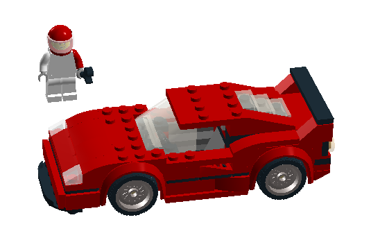

My first job was simple: model 75890 (the car I gifted to my kid). Just to make practice. Now I go for to the Millenium Falcon.

4 hours ago, corboa said:
I get it. Thank you again.
Nice car. But looks like a big step to go to Millenium Falcon - Enjoy :) !

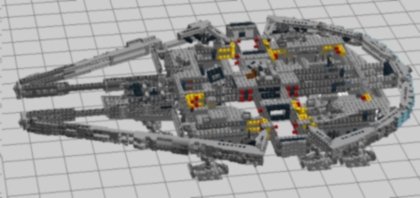

Thanks. I've been building the MF for a week. Almost 2000 bricks used so far. Currently ON HOLD :)
