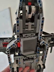

Hi all, I've managed to mod an old battery box into the hull. Trick was to extend the wheel housing 2 studs forwards.
Second mod was borrowed from an earlier post on this thread, modding the tail. I agree that the curved panel looks better than the original. So I printed the Black Knights logo and laminated it. I don't really like putting stickers on my lego, so taping laminated prints is a good solution in case I want to take the image off in the future.
Next project: turning the wings and folding the props! I'll borrow from Efferman's initial model as much as I can, but will probably make it a manual operation rather than adding another mechanical gear to the structure.
