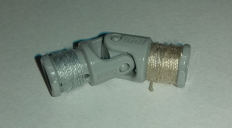

If you have this problem, you might have wondered what can be done to strengthen a 3L universal joint.
You can wrap bands or string around the connections to strengthen them:
This will help to a degree as they won't snap so easily where the one in the first image has, but then you're just looking for the next weak link, and in this case it's the yokes which will spread and spit out the disc never to be seen again.
