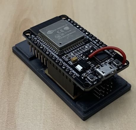

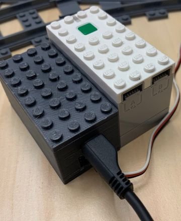

Smotek7 Posted December 30, 2020 Posted December 30, 2020 Today I created a prototype HW for LEGO servo HUB. 4 output ports for RC servo. Just wait for the SW modification. Quote

Smotek7 Posted August 15, 2021 Posted August 15, 2021 (edited) This is probably my latest version. It's just a modified example, I don't have a description there. I think only 4 outings can be made. It's a limited Lego app. Only add more pieces of ESP2, it can be distinguished in the app. Edited May 2 by Smotek7 Quote
