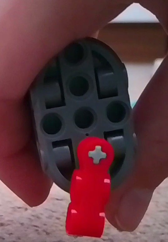

Lego has more than the L motor in the PU group, see the medium angular motors from the Mindstorms/SPIKE which have more pinholes
