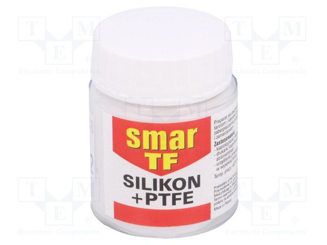

JaBaCaDaBra Posted June 27, 2020 Posted June 27, 2020 I use this ptfe grease, works perfect and doesn't damage anything. Ow, and the price is also attractive. Quote
