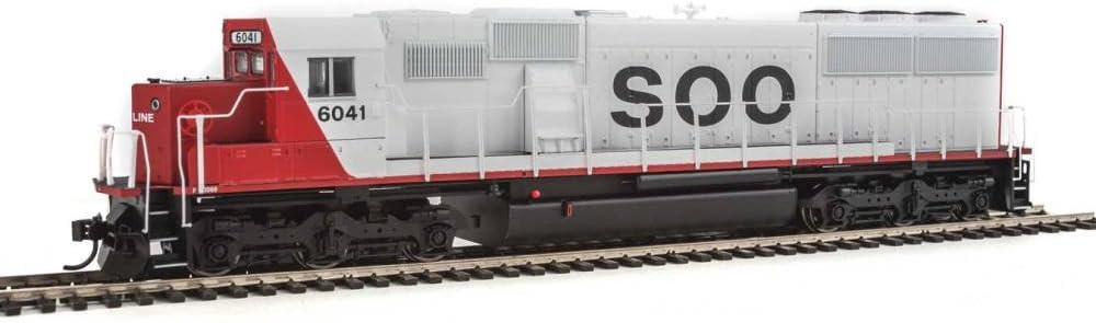

So far the best result I got is this link: LEGO custom CP SD60. Would you say this fits my model? As you can see on the pictures, my train has Canadian Pacific stickers and the number 4789 and a kind of buldge on the left side which would fit the EMD SD60 according to pictures like this: EMD SD60.
