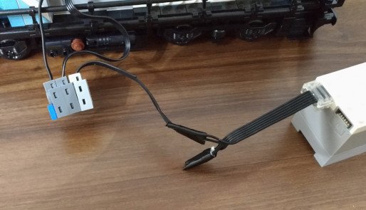

Wabbajack Posted February 17, 2020 Posted February 17, 2020 This is my solution: I already had two PF motors, I just got an extension cable and a PoweredUp ligths (the cheapest). I made an adapter cable and I also opened one of the motors to switch its polarity. I think I found all the info for these changes on this forum. I was also experimenting with using 2x18650 Li-Ion batteries (3200 mAh = 3x capacity) instead of the AAAs with the PU circuit board, but I have to figure out how to fit them in the Maersk. However, a full charge of AAAs gave me a long enough runtime, so I put that project on pause. I really like the Bluetooth capability and hope to find time to experiment with some python scripts to run my trains from a Raspberry Pi. Also it is nice to have the extra room when you scrap the PF IR reciever. Quote
