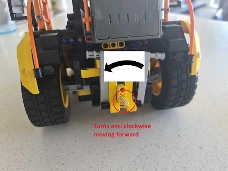

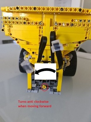

willba Posted November 8, 2020 Posted November 8, 2020 Hi, I posted on here recently with trouble I'm having with the Volvo articulated hauler. I have fully rebuilt twice and I am still having the same issue with front two wheels turning the opposite way to the rear four wheels. Does anyone else have this build completed that may be able to help with the attached pictured? This is the rear part of the built and the connection point turns anti clockwise when moving forward. This is the front part which also turns anti clockwise when moving forward. When joined the two halves want to turn in opposite directions moving forward or backwards. If anyone has this and can tell me which part is turning in the incorrect directions I would be eternally grateful as I have no idea where I have gone wrong! Quote
Jurss Posted November 8, 2020 Posted November 8, 2020 I think it was already answered - change front differential, so that its main gear is on other side. Quote
anyUser Posted November 8, 2020 Posted November 8, 2020 On 11/8/2020 at 3:47 AM, willba said: I posted on here recently with trouble I'm having with the Volvo articulated hauler. I have fully rebuilt twice and I am still having the same issue with front two wheels turning the opposite way to the rear four wheels. This is the front part which also turns anti clockwise when moving forward. When joined the two halves want to turn in opposite directions moving forward or backwards. If anyone has this and can tell me which part is turning in the incorrect directions I would be eternally grateful as I have no idea where I have gone wrong! Expand Hello, if your description refers to observation made when pushing the truck - e.g. not using the motor to move: This is perfectly OK. The drivetrain is powered via the dark grey differential between rear axles and front one. The propulsion input to the differential housing is always connected to the motor that works as a stop at this point. Therefore the two output sides of the differential are rotating in opposite directions if wheels are turned by hand: You cannot push the hauler by hand. You need to activate the motor to have all wheels turn in the same way. Verify that you have aligned the differentials as shown in step 340 on page 219. When I lay my hauler on its side and spin on of the rear wheels, the other rear wheel rotates in the same direction and the fronts wheels rotate in the opposite direction. The housing of the grey differential, e.g. the 24-tooth side of it, are visible from the bottom: It does not turn. Quote
willba Posted November 9, 2020 Posted November 9, 2020 On 11/8/2020 at 8:24 AM, anyUser said: Hello, if your description refers to observation made when pushing the truck - e.g. not using the motor to move: This is perfectly OK. The drivetrain is powered via the dark grey differential between rear axles and front one. The propulsion input to the differential housing is always connected to the motor that works as a stop at this point. Therefore the two output sides of the differential are rotating in opposite directions if wheels are turned by hand: You cannot push the hauler by hand. You need to activate the motor to have all wheels turn in the same way. Verify that you have aligned the differentials as shown in step 340 on page 219. When I lay my hauler on its side and spin on of the rear wheels, the other rear wheel rotates in the same direction and the fronts wheels rotate in the opposite direction. The housing of the grey differential, e.g. the 24-tooth side of it, are visible from the bottom: It does not turn. Expand Thanks for getting back to me, glad to hear that the wheels should no be able all turn in the same direction and the hauler cannot be pushed by hand. I've made sure all differentials are aligned in step 340 on page 219, I paid very particular attention to this on the rebuilds. When I lay the hauler on the side and spin the rear wheels, the housing of the grey differential does not turn like you have pointed out. Could it be possible one of the two motors in the rear is faulty? Is there any way to test this being possible? I was so careful following the build instructions considering full rebuilds so I think it has been assembled correctly and as laid out in the instructions.. Thanks again for your help! Quote
