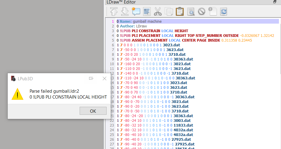

Probably you need to add a number to the end of the constrain local height line. Or just delete it. Use a text editor if you can't open the file in LPub.
Hope that helps! :classic:
Yes, delete it, (highlight the line of text and delete). Then redraw the page and see what the PLI looks like. PLI= parts list image. That "CONSTRAIN LOCAL HEIGHT" is about the size/shape of the PLI box.
You have an awful lot of parts in that step.  That could be why the parse failed. Can't see from your picture how many there are. i would be willing to take a look at your file. You can private message it to me if you like.
