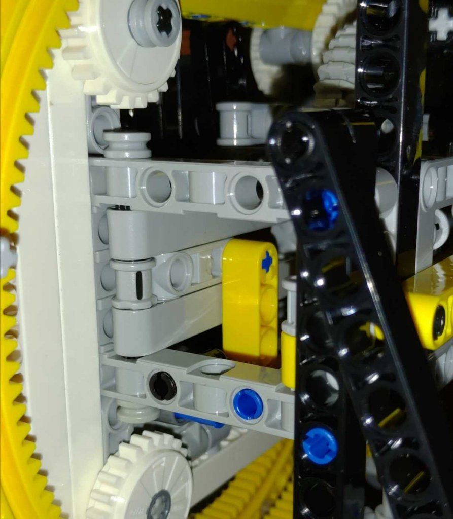

doug72 Posted August 23, 2019 Posted August 23, 2019 (edited) Ball Loading- Anti Jamming Modification # 2 As mentioned in the instruction notes, the balls can sometimes get jammed at the loading gate and get ejected at high speed from the module. This can also upset the timing. The sharp corner as shown below is the cause. Modification:- Remove the studded bricks (outlined in purple) and replace by stack of 3 x 5L beams. Beam A is pressed onto the base plate and 3 x 3/4 DBG pins inserted. Beam B place over the 3/4 pins and 2 x black pins inserted into the other pin holes Beam C added. The round corner pushes any extra ball back up the ramp as the ball loading unit moves three balls onto the ball carrier. Since making this mod I have not had any jams on this module. Edited August 26, 2019 by Doug72 Quote

Maoie86 Posted September 7, 2019 Posted September 7, 2019 On 9/4/2019 at 4:36 PM, Doug72 said: White 24T gears will work OK. It doesn't work. The 24T white gear is hitting the horizontal 11m beam. Quote
doug72 Posted September 7, 2019 Posted September 7, 2019 (edited) 4 hours ago, Maoie86 said: It doesn't work. The 24T white gear is hitting the horizontal 11m beam. Oh Dear, in that case a 24T gear would also foul the 11L horizontal beam. Just checked my build and clearence is very tight even with the rubber tire but able to work OK. The hub with tire has a slightly smaller diameter and will slide through the middle of a 5 x 7 frame , where as 24T gears don’t. Suggest replace the two rear white 24T gears with four LEGO Wedge Belt Wheel (2786 / 4185) which have same diameter as rubber tire wheels. Edited September 7, 2019 by Doug72 Quote
Maoie86 Posted September 7, 2019 Posted September 7, 2019 (edited) 14 hours ago, Doug72 said: Oh Dear, in that case a 24T gear would also foul the 11L horizontal beam. Just checked my build and clearence is very tight even with the rubber tire but able to work OK. The hub with tire has a slightly smaller diameter and will slide through the middle of a 5 x 7 frame , where as 24T gears don’t. Suggest replace the two rear white 24T gears with four LEGO Wedge Belt Wheel (2786 / 4185) which have same diameter as rubber tire wheels. Thanks. I still used the 24T white gears but moved the beams instead. :) Edited September 7, 2019 by Maoie86 Quote
