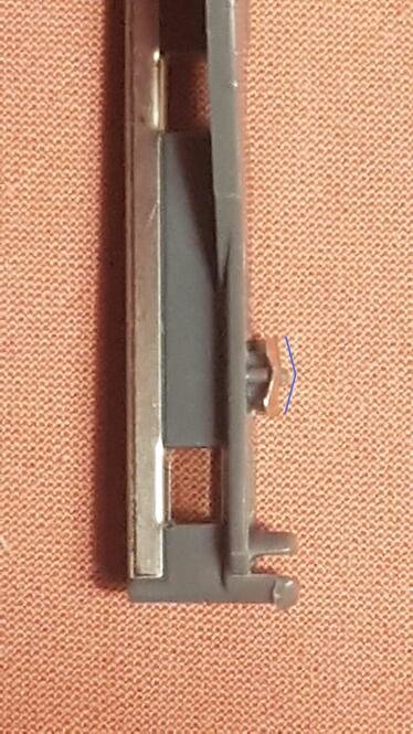

My replacement tiebars arrived. I replaced them according to the instructions given in the FxBricks-Blog of November 10th. However, after replacing the tiebars the switch-rails are out of power (only the switch rails are powerless, all non-moveable rails are powered correctly). Perhaps I damaged the thin metal/foil on the underside of the switch rail (it looks slightly deformed), although I proceeded with utmost care. Anybody else experiencing similar problems?
EDIT: I found the problem. The foil-thin metal on the underside of the switch rails was bent down (see image, bending indicated with a blue line). After carefuly bending it into an even position it works and both switch rails have power!
Edited by El Schaeferino

As for what @El Schaeferino said, here's what i found:
  • When you push, pull etc. The switch rails out to replace the tiebar, there is indeed a small iron piece on the underside which bends a little because of the small square cutout hole where the switch rail makes contact with the rest of the switch for electrical power and it has to do with the fact that when you pull the switch rail out you probably ( as i have done) twisted end turned them to get them out but because of the angled pull, the iron contact bends slightly. With some gentle pressure from your nails you can bend it quite straight again, but be carefull though. Bend them slightly down but still attached to the knob which keeps it in place so that when you place them back in the switch they will pressure themselves better against the metal plate in the switch, but do keep them  attached to the knob tho!
  • When placing the switch rails back after replacing the tie bar ( which has been checked for the minimal friction position ) i would highly recomend to first add the switch rails to the tie bar (do this 1 switchrail at a time ) and then, ( This is important!! ) place the switch rails in a straight maner back in the switch so the metal connector is aligned to the square hole so it doesn't bend or something for ultimate contact for the electrical power to feed through them.
  • If you have done this, i would check if everything works the way it's supposed to do and if so, i woud check if the power is still consistant through the switch rails and if not you should check the switch rails again to get the iron part to make contact.
I have done it in the way i writed above and all switches work fine!! What a difference in friction with those new tiebars, now i will drive the switches absolutely crazy lol!

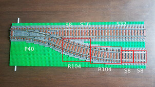

In the Product Guide for the P40 switch Fx Bricks hinted that it may be possible to replace the R64 return curve with two R104 curves. This creates a small gap (1.78mm) that is too great to connect the curves directly to the divergent route, but when you insert two S8 straights they can absorb the gap at the joints with minimal stress to the material. This can even be ballasted and looks nice (see picture).
At Holgers website there is a small article about this idea.
https://www.holgermatthes.de/bricks/en/fx-bricks.php
