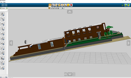

First time posting here. I had a quick question, as my LDD seems to have messed up on me severely.
I am building the church where I work. All was going great until I zoomed out from doing some of the detail work in the sanctuary to find this lovely (and unexpected) change. If it helps, I believe somewhere throughout this process I used the Hinge tool to adjust something. Does anyone know of how to get this thing back down to the original plane?
Any help here would be greatly appreciated. Thanks!
Put a part (for instance a tile) on the ground.  It will be flat.
Then grab everything else and connect it to that part (for instance on your baseplate).
You can then remove the part (and finally reselect everything to move it once more to have it correctly centered).
