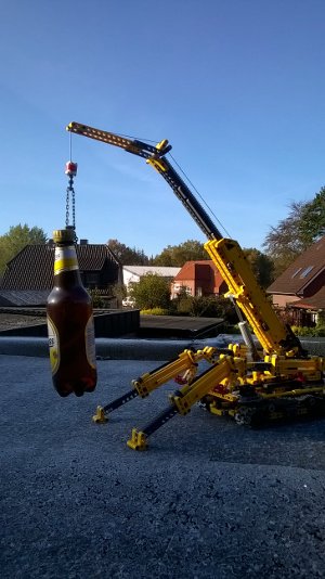

Plastik Posted October 31, 2019 Posted October 31, 2019 (edited) Hello all, today I found an easy way to increase the lift capacity to more than 500 grams. I just turned the rear supports to front to support the front supports and connect the T-pieces of the rear stands to the L-pieces of the front supports. Adding the now free 1x3 liftarms to these conections improves the stability, so that the crane is able to carry about 650 grams, thought then the higher part of the crane arm bends extremely. I also explained this easy task in German in this thread: https://www.1000steine.de/de/gemeinschaft/forum/?entry=1&id=427774#id427774 There you can also find three additional pictures. Thank you for reading and greetings from Lower Saxonia, André (Plastik) Edited October 31, 2019 by Plastik Quote
Plastik Posted November 5, 2019 Posted November 5, 2019 (edited) Hello all, now the crane lifts more than 900 grams. Seven pieces that are not included in the set were added to stabillise the joint between the crane arm and the jimb. See the same thread with two additional pictures. Cheers, André Edited November 5, 2019 by Plastik Quote
