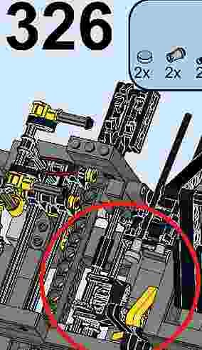

Hi Berthil. I am progressing slowly but I have almost completed the raw portion of the build. The next portion will be tuning.
What is not clear to me, is the loop-back exit. If you look at the picture, the 2 hoses are positioned too far from the left ramp exit and there is no barier that would direct the rolling balls to the path made by the hoses. (The other exit seems to be OK.) In your video, where you show the loop-back, there is a brick built barier that seems to work well.
@Jonas It seems the hoses need to be further back, I will correct. I might have forgotten to show the brick build barrier which is needed to stop de balls. I will check and add it. Thanks for noticing.

Allow me another small comment. When you make an update of part 2, look at black 6L axle added in step 167 (the axle to rotate the black lever). This axle passes only through holes and hence it is not fixed in its position. I myself fixed it in step 168 by adding a bush (e.g. 3713) in between black Axle and Pin Connector Angled #1 (32013) and black Pin Connector Plate with One Hole (32529).
And a question to the large basket wheel. Its stand (4 vertical 13L liftarms) seems to me like 'hovering' just one brick high above the tiles laid on top of a 2x6 brick. Yes, it is fixed in place by the 4 red axles but one needs to move the stand back and forth in order to align the holes in the stand and the platform. I added another 2x6 brick on top of the first one and now the stand sits on the tiles and the holes are aligned perfectly.
And before I end this post, I add one personal (lame) experience. I spent almost one hour to find out why the large wheel - when added to the platform - did not fit with the rest of the system. I searched for mistakes here and there, just to realize (and remember forever) that the wheel stand is NOT symetrical and that it must be placed in one specific direction. If you add such a notice to the BI, it may help some other builders.
@Jonas thanks again! I will check the Wheel alignment but it should be so that the black crossbeams (with 1x1 connectors) between the 4 13L liftarms should rest on the 1 x 5 thick liftarms already connected to the frame. These 1x5 liftarms are also guides when placing the wheel. But I will check, may be something got shifted during the last fix, in the finished model in Studio it is sometimes hard to see with all these parts surrounding it :)
I will check the rest and update/improve accordingly.
Edit, I checked Wheel position with 1x5 Liftarms positioning/rest and this is correctly placed in the model.
I will update the BI if it is not clear enough. Part 4 needs to be updated anyway, I see now that in current PDF all callouts somehow have been converted to pages instead of callouts.
Edited by Berthil
Thank you, Berthil. Now, it is clear. When building the wheel stand, I did a minor modification (because I was missing one specific element) and this caused the above mentioned troubles. I apologize for a false alarm.
