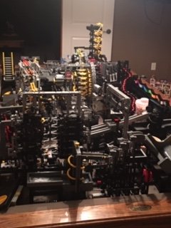

RickBobbie5 Posted March 28, 2019 Posted March 28, 2019 (edited) Sorry, forgot to use the quote button. "Sounds good. Any videos or your modules? My build will be different from the first build, I will use more studless. Although I will be using 16L DBG technic bricks as much as possible as I have many from a Lugbulk. Pictures soon as promised. Edited 1 hour ago by Berthil" Those DBG 1x16 are really not to available in the USA without many trips to Bricklink. I have a huge amount of technic models in another room and realized that the Bucket Wheel Excavator "42055" has about 75 of the 1x15 DBG studless beams so I may try to incorporate as much of that as possible to keep cost down. I realize the bricks are stronger than beams so it may be a combination of both. No videos yet but a small portion of what I have built has consumed my billiards table. Edited March 28, 2019 by RickBobbie5 Quote
Berthil Posted March 28, 2019 Author Posted March 28, 2019 @RickBobbie5 That's a very small picture of an excellent and big collection! I hope you share through events because that's a pitty to just leave on your billiards table :) Quote
