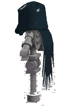

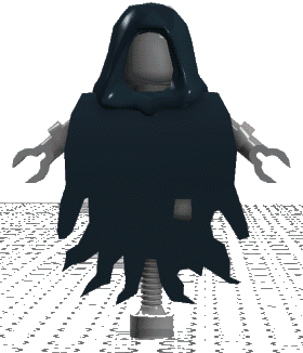

I did it, but its broken :(
I extract game files and take a model from here. Its working, i'll already make a kit fisto head from Lego star wars the comlete saga, and some more headpieces from here. But i have problems like this. Can someone help me?
