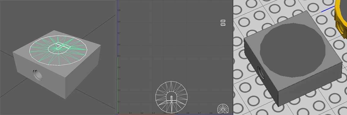

I'm currently working on adding in some of the updated magnet elements, but am running into an issue with the outline generation. Namely, despite the model UV shells being set up so that the edges should define the outlines (which is how LEGO does it, and I suspect/hope @polymaker does too), the outline generation ignores flat surface features, such as a border of the magnet and the magnet icon inlays. See the images below for more info. Can anyone tell what I may be doing wrong?
Edited by ProfessorBrickkeeper
@ProfessorBrickkeeper This is actually a "feature". My algorithm considers overlapped edges as fused. This is mostly to prevent generating outlines around decorable surface that are coplanar with non-decorable surfaces (e.g. the face of a minifigure head).
I plan to add more control over this process in brick studio but currently you will have to use a little trick (found by @Stephan IIRC):
Simply pull apart the model in brick studio so each surfaces to outline are separated, then generate the outlines and then put them back to their original positions.
