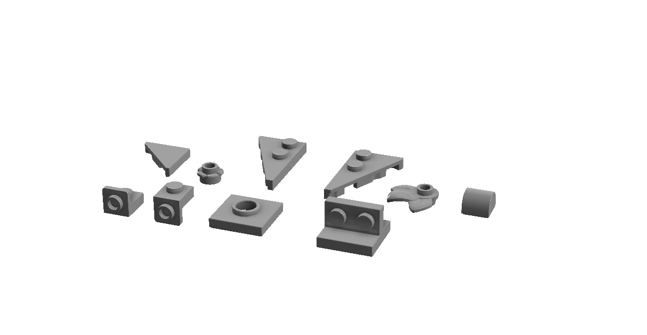

Jason C. Hand Posted December 3, 2019 Posted December 3, 2019 (edited) Think I finally cracked the code! Fiddled around with the XML files I created for Nos. 36840 and 36841; these results are the best that I could muster, though still must figure out how to fit pieces underneath 36841, as I am running into collision issues. Anyways, hope you enjoy what you see! Edited December 3, 2019 by Jason C. Hand Quote

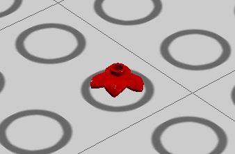

jester Posted May 5, 2020 Posted May 5, 2020 (edited) Thank you for tutorial guys!!! The next question is: how to create decoration map for new parts (or simplier - two-colored parts like 35660) Edited May 5, 2020 by jester Quote
jester Posted May 7, 2020 Posted May 7, 2020 (edited) 3 hours of coding | Edited May 10, 2020 by jester Quote
jester Posted May 9, 2020 Posted May 9, 2020 (edited) Sorry for maybe spamming, but i can't stop Edited May 10, 2020 by jester Quote

jester Posted May 9, 2020 Posted May 9, 2020 (edited) On 5/9/2020 at 10:05 AM, Stephan said: OMG... And I'm even struggling to get 1 working Which parts did you add? My small update for last 3 days Edited May 10, 2020 by jester Quote

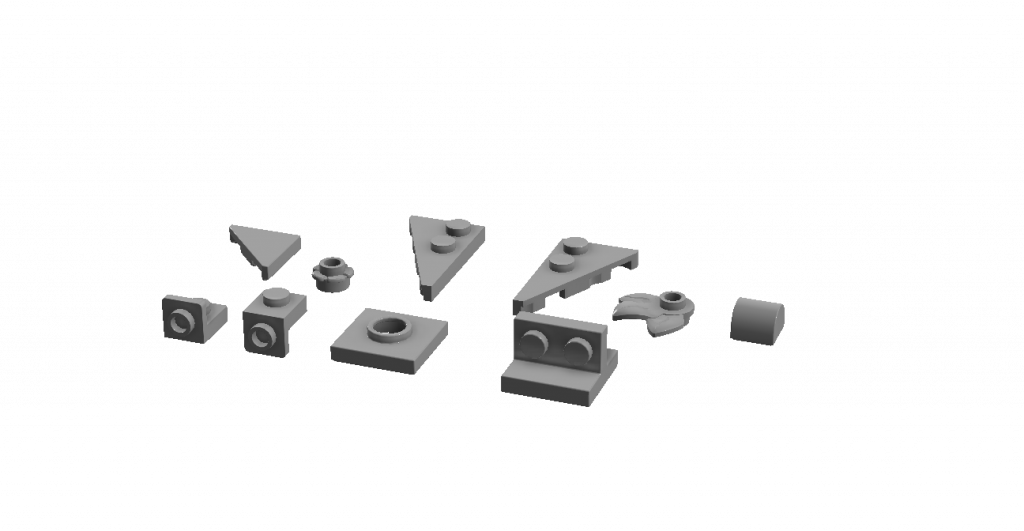

Stephan Posted May 9, 2020 Posted May 9, 2020 5 minutes ago, jester said: My small update for last 3 days I managed to do these parts. I couldn't manage to do the more complex parts (taken from LDraw...): Quote
jester Posted May 9, 2020 Posted May 9, 2020 (edited) On 5/9/2020 at 12:30 PM, Stephan said: I managed to do these parts. I couldn't manage to do the more complex parts (taken from LDraw...): I'm a quick study. Also forgot those parts Edited May 10, 2020 by jester Quote

Stephan Posted May 9, 2020 Posted May 9, 2020 9 hours ago, Stephan said: I managed to do these parts. I couldn't manage to do the more complex parts (taken from LDraw...): If anyone is interested in these parts, please let me know. I don't know if I'll be able to do it as good as Jester though Quote

jester Posted May 10, 2020 Posted May 10, 2020 (edited) 5 minutes ago, Calabar said: It is possible to share these parts so that everyone could add it to LDD with a simple procedure? It would be very interesting to open an indexed topic with the new parts or, even better, a "pack" maintained by an expert user, it could give new life to LDD. @jester It seems that the image hosting you are using don't support hotlinks, it is necessary to copy the image url and paste it in the address bar in order to see the image. Maybe you could use a LEGO related file hosting such brickshelf or bricksafe. New parts - https://drive.google.com/open?id=1TvqeAikmMU0THUCc0a4YNScICgjd7kiV I'll take a look what i can do with images, thanks! Also update for today Edited May 10, 2020 by jester Quote
