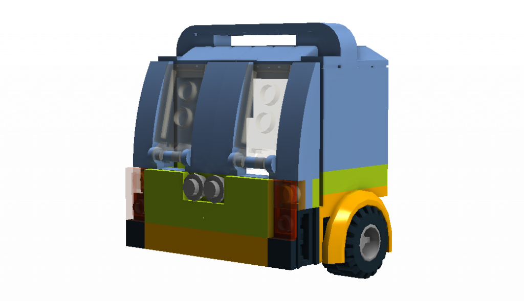

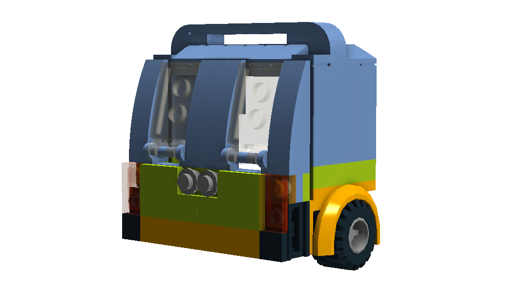

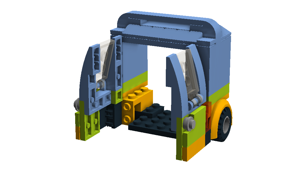

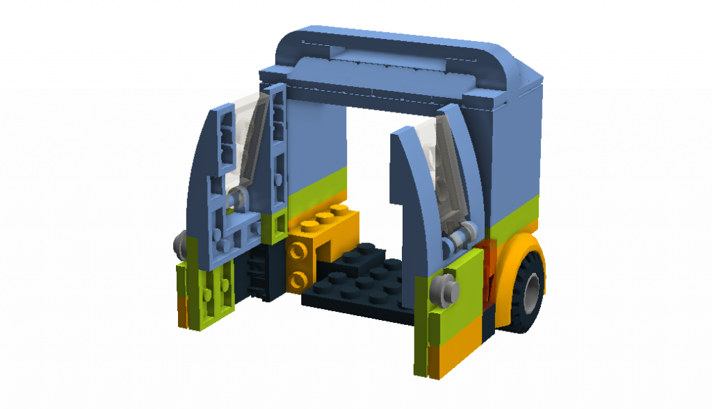

Here's the new reworked Mystery Machine.
For the back I ended up using the design from this A-team van MOC I found on Google images. which allowed me to round it off and add more accurate detailing.

Nice! I was actually going to suggest that design for the back, but decided against it since it makes the doors so thick and causes the side walls next to the doors to split open along with the doors, but if you're ok with that, it's probably the easiest solution.
