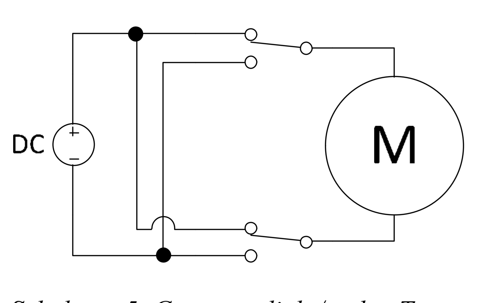

XGBC Posted January 14, 2019 Posted January 14, 2019 you could also if you are willing to mod lego build a so called "kurzschlussbremse" dont worry it will not short out your electronics it works by putting positive or negative voltage on both of the motors terminals and it will stop your motor more or less imediatley. but as always when you are dealing with electronics Be Careful i've also posted a diagram of the circuit below XGBC Quote
Mr Hobbles Posted January 14, 2019 Posted January 14, 2019 9 minutes ago, XGBC said: you could also if you are willing to mod lego build a so called "kurzschlussbremse" dont worry it will not short out your electronics it works by putting positive or negative voltage on both of the motors terminals and it will stop your motor more or less imediatley. but as always when you are dealing with electronics Be Careful i've also posted a diagram of the circuit below XGBC The PUP motors and hub have this built in, this is what speed value 127 triggers (As opposed to value 0, which lets the motors float to a stop). Quote

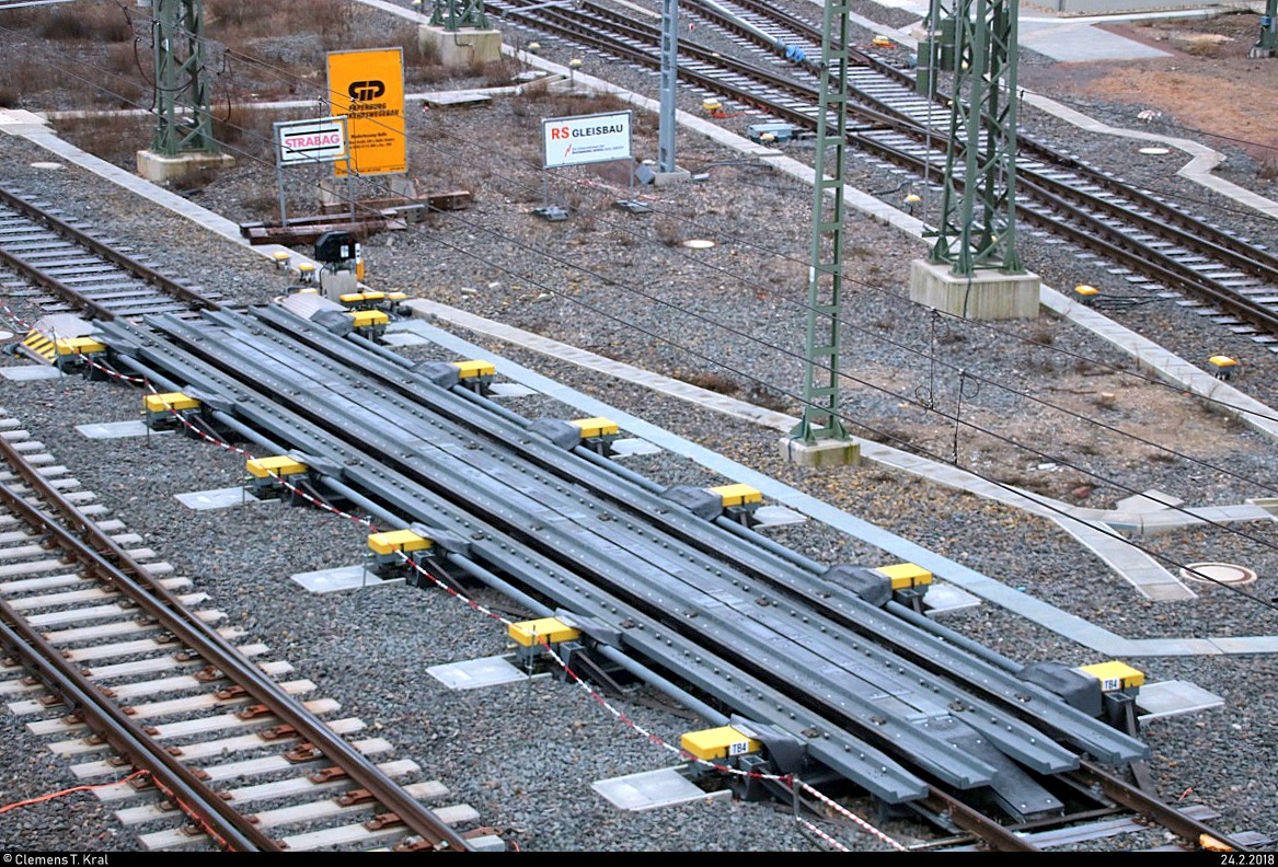

XGBC Posted January 14, 2019 Posted January 14, 2019 you could also build something like this: it is a machanical brake wich brakes the inside flanges of the weels XGBC Quote
Cosmik42 Posted January 17, 2019 Author Posted January 17, 2019 On 1/14/2019 at 7:22 PM, XGBC said: you could also build something like this: it is a machanical brake wich brakes the inside flanges of the weels Thanks for both suggestions! I use PUP trains and managed to use the fast brake from @Mr Hobbles suggestion. Now I wonder how to build such braking system in Lego. Thanks for showing such real-life system! Quote
XGBC Posted January 17, 2019 Posted January 17, 2019 these braking systems are mainly used for shunting wagons and are not used to slow locomotives down. They work using pneumatic or hydraulic cylinders. If you want to build such a system you have to raise your rails by a brick or two in height so you are able to fit the mechanism in there. Hope to see such thing soon from you XGBC Quote
