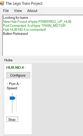

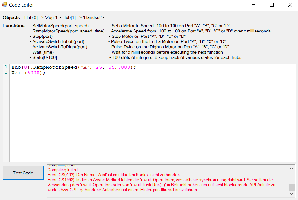

Lok24 Posted January 10, 2019 Posted January 10, 2019 (edited) Hi, thank you for your quick response. here is the slider: And here the "Wait" command", "Compiling failed". Ramp with start-value works fine. Edited January 10, 2019 by Lok24 Quote
Cosmik42 Posted January 10, 2019 Author Posted January 10, 2019 Can you copy paste the error and put it in Google Translate into English? Thank you! Quote
Lok24 Posted January 10, 2019 Posted January 10, 2019 (edited) I can and I will... ... here it is.... Compiling failed.Error (CS0103): The name 'Wait' does not exist in the current context.Error (CS1998): This async method lacks the 'await' operators, so it runs synchronously. You should consider using the await operator or await Task.Run (...) to wait for non-blocking API calls or perform CPU-bound tasks on a background thread. -------------------- Compiling failed. Error (CS0103): Der Name 'Wait' ist im aktuellen Kontext nicht vorhanden. Error (CS1998): In dieser Async-Method fehlen die 'await'-Operatoren, weshalb sie synchron ausgeführt wird. Sie sollten die Verwendung des 'await'-Operators oder von 'await Task.Run(...)' in Betracht ziehen, um auf nicht blockierende API-Aufrufe zu warten bzw. CPU-gebundene Aufgaben auf einem Hintergrundthread auszuführen. Edited January 10, 2019 by Lok24 Quote
Cosmik42 Posted January 10, 2019 Author Posted January 10, 2019 Ooops! I know what it is! Try this new build: https://www.dropbox.com/sh/1tqcy0zuylgdn7p/AAAAwo-mzu5GcqLBRYiDOzNDa?dl=1 Quote
Lok24 Posted January 10, 2019 Posted January 10, 2019 (edited) Indeed, much better, THX Works: Hub[0].RampMotorSpeed("A",25, 75,3000); Wait(5000); Hub[0].Stop("A"); Does not what I expect Hub[0].RampMotorSpeed("A",25, 75,3000); Wait(5000); Hub[0].RampMotorSpeed("A", 75,25,3000); Hub[0].Stop("A"); Edited January 10, 2019 by Lok24 Quote
Cosmik42 Posted January 10, 2019 Author Posted January 10, 2019 So now the 'Wait(6000)' simply stop the execution for 6 seconds while letting any Ramp or other asynchronous things do what they are supposed to do. One last thing. I just did one more upload to try to fix your speed label. From the screenshot you shared I can tell your default windows font size is larger than mine, which is why the speed value doesn't show. I just increased slighted the width of that label. Let me know if that fixes it! Quote
Lok24 Posted January 10, 2019 Posted January 10, 2019 (edited) Yes, it accelerares with in three seconds, the wait is six, so it runs fur further three seconds. 11 minutes ago, Cosmik42 said: One last thing. I just did one more upload to try to fix your speed label. From the screenshot you shared I can tell your default windows font size is larger than mine, which is why the speed value doesn't show. I just increased slighted the width of that label. Let me know if that fixes it! Sorry, but no. Moving the slider very carefully only 7 numbers are shown: 0, 2,5,8,-2,-5,8 But thats not critical in any way. Is there a method to use "RampMotorSpeed" to decrease the speed? Edited January 10, 2019 by Lok24 Quote
Cosmik42 Posted January 10, 2019 Author Posted January 10, 2019 34 minutes ago, Lok24 said: Sorry, but no. Moving the slider very carefully only 7 numbers are shown: Again, it's because your default font is much bigger than mine. I will try to find a way to force the size of the font in that label. 35 minutes ago, Lok24 said: Is there a method to use "RampMotorSpeed" to decrease the speed? RampMotorSpeed("A", 0, 1000) should decelerate over 1 second. Quote
Lok24 Posted January 10, 2019 Posted January 10, 2019 Thanks. It's not that important with the numbers, Perhaps I find a way to change de default font size in Winows. Quote

Bartosz Posted January 11, 2019 Posted January 11, 2019 16 hours ago, Cosmik42 said: So now the 'Wait(6000)' simply stop the execution for 6 seconds while letting any Ramp or other asynchronous things do what they are supposed to do. That's getting interesting. How's this handled under the hood? 2 minutes ago, Cosmik42 said: Hub[0].RampMotorSpeed("A", 75,25,3000);Wait(3000);Hub[0].Stop("A"); Maybe the API should have the non-async and async variants for such methods so that it's clear what's happening? Quote
Cosmik42 Posted January 11, 2019 Author Posted January 11, 2019 (edited) Quote That's getting interesting. How's this handled under the hood? I had to create this behavior because a simple Thread.Sleep was killing sensors reading, async behaviors, etc. Here is what I do: e.CodeToRun.Replace("Wait(", "await Task.Delay(") Just now, Bartosz said: Maybe the API should have the non-async and async variants for such methods so that it's clear what's happening? Maybe! Edited January 11, 2019 by Cosmik42 Quote
