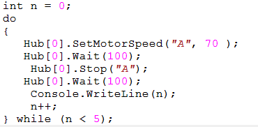

Giottist Posted January 8, 2019 Posted January 8, 2019 If I unstand it correct, we can write small c# code which is executed as a result of different sensor messages. Does the C# interpreter (?) allow loops like for oder do while and branches like if else or case and local variables? Quote
Lok24 Posted January 8, 2019 Posted January 8, 2019 (edited) Hi Cosmik42 , thanks for your quick answer! But: where can I find the "new" version? And, I'm very sorry, more questions: What does a syntax for RampMotorSpeed(Port, 1000,1000) mean? (I assume Port,v,time) And what about others motor types, which can be moved by a specific angle, like Boost or WeDo? (but perhaps they pop up when I attach one) Edited January 8, 2019 by Lok24 Quote
Lok24 Posted January 8, 2019 Posted January 8, 2019 (edited) 44 minutes ago, Giottist said: If I unstand it correct, we can write small c# code which is executed as a result of different sensor messages. Does the C# interpreter (?) allow loops like for oder do while and branches like if else or case and local variables? Yes, I just tried (part of your question): Edited January 8, 2019 by Lok24 Quote

Cosmik42 Posted January 8, 2019 Author Posted January 8, 2019 (edited) 1 hour ago, Lok24 said: But: where can I find the "new" version? The V0.3 link at the top of this thread. Here it is again: https://www.dropbox.com/sh/g32wsw502jwv6oj/AAC0EycS7kgCIluhtVmKt1k3a?dl=1 1 hour ago, Lok24 said: RampMotorSpeed(Port, 1000,1000) It should be RampMotorSpeed(Port, Speed, Time), so it will look like this: RampMotorSpeed("A", 70, 1000) where 1000 is in millisecond and is the total time of acceleration/decelaration. Edited January 8, 2019 by Cosmik42 Quote

Cosmik42 Posted January 8, 2019 Author Posted January 8, 2019 44 minutes ago, Lok24 said: Yes, I just tried (part of your question): BTW - You can write "MainBoard.WriteLine("...."); to log in the program's console. 9 minutes ago, Bartosz said: @Cosmik42 pardon if it's been asked/answered somewhere in this thread - is the source available /is it going to be open sourced? For now there's no clear plan on releasing the source officially, mostly because it is a side project and the code is really ugly :D 41 minutes ago, Toastie said: Again: Thanks a million Cosmik42, for doing all this for us!!! Thank you @Toastie! Quote

Cosmik42 Posted January 13, 2019 Author Posted January 13, 2019 On 1/8/2019 at 7:06 PM, Giottist said: Does the C# interpreter (?) allow loops like for oder do while and branches like if else or case and local variables? Sorry @Giottist, I totally missed your post. Yes indeed! You can in fact use everything C# has to offer since the code is fully compiled and executed on demand. This a powerful tool to write complex behaviors and scripts! Quote
