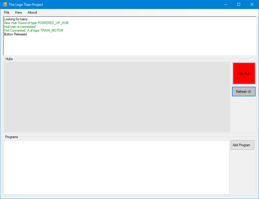

TheLarry98 Posted January 7, 2019 Posted January 7, 2019 I have another problem. With the V0.3 I no longer control my trains. No hubs are shown. Refresh Ui does nothing for me. What do I do wrong? Quote
Toastie Posted January 7, 2019 Posted January 7, 2019 Dear All, I think we should maybe calm down a little. What @Cosmik42 is achieving here is simply incredible. Whereas the PuP tear down thread laid the foundation, the official release of the LEGO protocol ("official" as in "considerable preliminary" - that document is indeed far from anything TLG has released in the past. I am asking myself what has happend there … just cranking out stuff, as it appears. To me that is very disturbing - but oh my - that is only me) took us further, all the other spread-over-the-net findings even push things … as far as I am aware, Cosmik's software is the one and only that works almost flawlessly. OK there are bugs here and there, limitations not considered (e.g. with a particular BLE hardware not more than 5 hubs etc …), but this software is simply - stunning. Question is why "users" or better customers have to do that - but OK, maybe it is envisioned from the TLG perspective as a parallel to the "building experience". Thing is that folks who have no idea how to get the BLE protocol working are simply not in the building experience world. Which is OK: They gave us the remote control. Heck, with PF that was it! Get it going with the PF remote or find out yourself. I had to use a NXT brick equipped with a HiTechnic IRLink sensor plus RF hardware to get remote PF/RC train control from my computer working. With BLE things change considerably. All of a sudden wireless remote control is essentially built into a modern computer or smart device (I don't have any - SMS still works with my Nokia C3). It is so close. And very tempting. On the other hand it is not "simple". And a lot of very carefully performed work is required to get it going. I suggest that when we want support for "this and that" we should provide Cosmik with "this and that" hardware. I did that in the past as well. Was asking for RobotC support for RCX1.0 bricks. Well, sent one of these bricks to the RobotC developers - and boom got it. Even then though, we should remain calm. This is all very exciting. But this needs some time to develop AND BOLD TESTING. The latter part is often overseen: on one machine it (somehow) works (as if it was straight forward and as expected). Send out the good news. And then it all begins: There are myriads of machines out there - may run on Win7/8/8.1/10 (as Cosmik was telling us - he is a "former" windows programmer) - hey and XP (yes!), Vista, and what not. And: There is even more BL/BLE hardware. It appears as if there are more BLE sticks than you can count. Hope is all vendors paid very very close attention to the official BL/BLE rules and recommendations. All I am saying is: I believe it would be good to focus on TLG BLE stuff first and make that work as reliably as possible. And then expand into 3rd party hardware … Just my 2 cents ... All the best Thorsten Quote
Cosmik42 Posted January 7, 2019 Author Posted January 7, 2019 (edited) On 1/7/2019 at 10:00 PM, TheLarry98 said: I have another problem. With the V0.3 I no longer control my trains. No hubs are shown. Expand @TheLarry98, insteresting. I just made a debug version for you:https://www.dropbox.com/sh/l2t7pu6ltctp4l7/AAAKs69DVwtLGHCHDZdNaQG6a?dl=1 Can you download it, run it and let me know if the hub shows up? Also, if it does not, can you please click 'Add Program' and then 'Start Program'. Let me know the output then! On 1/7/2019 at 10:43 PM, Toastie said: I believe it would be good to focus on TLG BLE stuff first and make that work as reliably as possible. And then expand into 3rd party hardware … Expand @Toastie - I agree and this is my plan for now. @ElectroDiva - Unfortunately I do not own this hardware yet, and it starts to be a lot of protocols to follow up on. I still want to make the fundation robust for PuP for now and explore 3rd party protocoles once the automation is clean. Though thanks for pointing out at this other protocol! Edited January 8, 2019 by Cosmik42 Quote

Lok24 Posted January 8, 2019 Posted January 8, 2019 (edited) Hi Cosmik42, my first PoweredUp components arrived and work fine. Just downloaded your program: awesome! Thanks al lot! But I'm a little bit confused, I'v got a file that saysV.03, but "About" V0.1. Now I found the "Debug V2" which seems to be more actual, but still "about V0.1" Did I mix something up? Which one should I use? The Debug V2 offers "refresh UI" and "configure" the ports (name for Motor etc.) Second: for the C# snippets Is there a list/and or summery for commads, parameters and usage? Edit: Ah, just found, in the new version tey are listed in the title. But the rampMotorSpeed is defined as (port, speed, time), but leads to an error (# of parameters) There are noc commands for Hub[0] ? Any help welcome! Edited January 8, 2019 by Lok24 Quote
Cosmik42 Posted January 8, 2019 Author Posted January 8, 2019 On 1/8/2019 at 4:07 PM, Lok24 said: I'v got a file that saysV.03, but "About" V0.1. Expand Oh good catch! It was hard-coded, now it is properly dynamic and will show the correct version (V0.3.1) On 1/8/2019 at 4:07 PM, Lok24 said: Is there a list/and or summery for commads, parameters and usage? Expand I was working on it today! I just added 'Autocomplete'! As soon as you type '.' it will show a dropdown list of valid function like this: On 1/8/2019 at 4:07 PM, Lok24 said: the rampMotorSpeed is defined as (port, speed, time), but leads to an error (# of parameters) Expand Oops! It is fixed in this updated version! Quote
