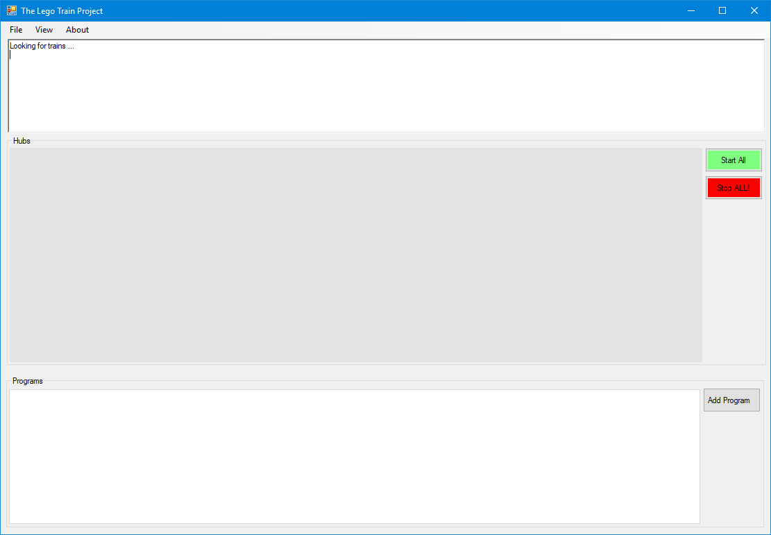

The Software can not find my two trains.
Both trains have the new firmware installed. Yesterday one worked but after a firmware update it stopped working.
Edited by TheLarry98
40 minutes ago, zephyr1934 said:
Does the software have the ability to simultaneously turn on both ports on a hub in opposite directions so that a engine can have two motors facing in opposite directions?
Absolutely.
They are not discovered at all?
Did you try to pair them? If so it is best that you remove any pairing.
Edited by Cosmik42
Did I miss something? I start the programm and than press the green button on the hub.
I already remove the pairing (it flashes purple) but nothing changed.
For now detection is based on the name of the Hub. I have a new version using UUIDs coming up.
Make sure your Hubs use one of these 3 factory names: 'HUB NO.4', 'LEGO Move Hub' or 'Smart Hub'.
Let me know if this helps!
Edited by Cosmik42
27 minutes ago, TheLarry98 said:
@Cosmik42 That was the problem. I renamed the trains earlier. Now it works. Thank you very much!
Great to read! This limitation will be fixed in the next release.

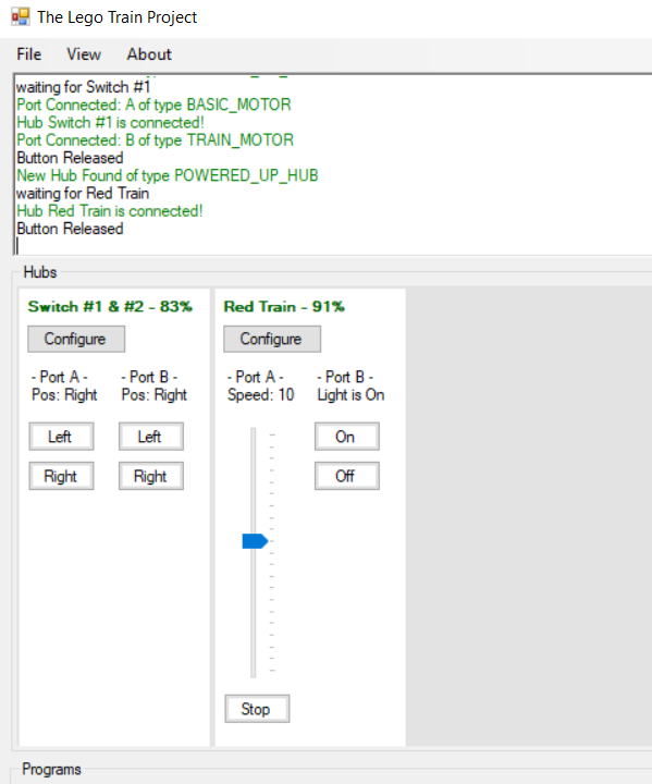

I am completely reworking the UI to be fully generic.
You can now configure manually a Hub, and be able to control 4 motors out of a Boost Hub if you wish so!
I should have an updated build at the end of the weekend!
V0.3 is out!
Here is a video that shows the UI improvement:
https://www.facebook.com/groups/2311775879052281/permalink/2319137371649465/
Major update with this version:
- New UI
- Improved Hub Detection
- Color In C# Editor
- Light Management
You can download the latest build here:  https://www.dropbox.com/sh/g32wsw502jwv6oj/AAC0EycS7kgCIluhtVmKt1k3a?dl=1

@Giottist - try to plug your old hub that did not use to work. If it is still recognized as a BOOST, you can now reconfigure its type.

1 minute ago, Giottist said:
Only the sensor shows no reaction (?)
I put distance and color debug at false by default now. But you can turn it back on from the 'View' option in the top bar.
Is it correct that the color sensor influences the programs?
Yes! And no need to code. Simply add a Program and then add a 'New Sensor Event'.
With this, you can tell a train to stop, accelerate, or many other things, just by picking in combo boxes!

The bug is gone (ok, there is still a heap of red error messages), thank you a lot for your IMMEDIATE reaction. I've found a missing program part: If I try to disconnect one hub by pressing the button until the led at the hub goes off the software does not recognize this but crashes after a while. For me it seem this part is not still programmed ;) Ok, this function is not so important since all hub switches off themselves after terminating the software.
24 minutes ago, Giottist said:
Perhaps I need help: I've activated the debug message but there is still no display ... Did I unstand something wrong?
Click here and debug should start showing. If it doesn't then your sensor was not properly detected.
