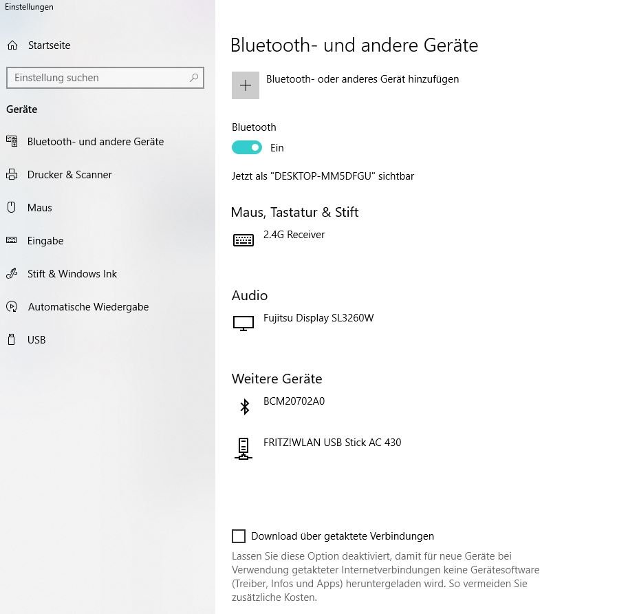

Didicas Posted March 23, 2019 Posted March 23, 2019 Very interesting software! It´s working with my PUP trains. At the beginning also my SBricks were working, suddenly I get always the error message "connected but discarding". I realy have no idea what I do different now except from one thing... I did a software update of the SBricks to version 25. Can this cause the problem? But I have no idea how to downgrate? What else can I try to do? Thank you very much for your support! Quote
Didicas Posted March 24, 2019 Posted March 24, 2019 I had the idea to check if the SBricks are connected with windows... If I see screen shot below they are unpaired, so in my view it´s okay. But what´s the problem? Quote
Cosmik42 Posted March 24, 2019 Author Posted March 24, 2019 Can you check if the SBrick is still called 'SBrick' - if not, please rename it 'SBrick' Quote

Didicas Posted March 24, 2019 Posted March 24, 2019 Indeed, that was the problem. Thank you very much Quote
