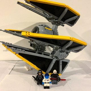

I started my MOC year 2018 by making the cheapest TIE craft in the Imperial fleet, and now I end this year by making the most expensive one. The TIE Defender only recently made it into canon, but back in 1994 when it debuted in Lucas Arts' TIE Fighter game, it was a beast.
Faster than an A-Wing, tougher than a B-Wing and more manouverable than the Interceptor, the Defender does all a starfighter does, just better*.
Now I have it in LEGO form... which was pretty interesting to get to. Because since there is no true canon representation of the ship except for Rebels... which I'll get to in short... I could give myself some leeway when it comes to accuracy and give it the coolest shape I could think of while still preserving core features.
The Defender as seen in Rebels has slightly different shape:
latest?cb=20170307140434
Much like... well, almost everything, Rebels took a nice design and changed it... for reasons unknown. Let's just say I am not a fan of this rear-heavy design, nor do I like the tall-neck ISDs or featureless toy-looking basic T/F line fighters. Not to mention if I went with this one it would tip forward because the center of mass is further to the front than the furthest flat piece of the wings.
Instead I based my design having this one in mind:
latest?cb=20171030213949
The only real alteration I did was making top guns a bit different to distinguish them - after all these are supposed to be ion cannons, and added visible missile launchers in a place which made at least some logical chance - on the panel centers.
Anyway no matter which design you pick, the Defender is an odd one. The ball is just tacked on to a triple support base, panels are bent in wrong way and it is always going to look top heavy because, well, it is.
Engines were contested point between me and BrickVault. We tried several solutions, but the final fight was between these two:
I still believe the Defender, being THAT FAST should have large, prominent engines, but eventually we picked a less-in-your-face design as seen on top, while still making more sense than what Rebels did with theirs.
Structurally this design perhaps the toughest one of all the ships to date, except maybe the Bomber. But it is hard to compare something to the Twin Flying Brick,
This is the first TIE in my line which has an interior, thanks to Inthert for inspiration!
It fits any kind of TIE pilot and altough you need to remove the quarter dome pieces to put him there, they are lightly attached on one stud so this is super easy.
Tell me what you think!

I see a topic with a new MOC from Jerac, I click. :classic:
What can I say? This is another excellent creation, which is expected from you I think we can say! I wanted to write about how I thought a particular part of the build was the best, but after scrolling up again I had to decide there is no best part ... let me summarize.
- Wings, very well done, they seem a lot harder to pull off than regular, square shaped TIE wings and the missile launchers look cool and realistic, and the four 1x1 tiles on the end of each wing give it that extra detail.
- The engines + stucture holding the wings and cockpit together, maybe not the first thing you would look at but looks great nonetheless. I think the engines not being too large actually looks good on this type of ship, and this comes from someone who loves big engines! Also, the red detailing at the engine compartment nicely breaks up the gray and black of the ship.
- The cockpit, the design doesnt look too complicated but it doesnt have to be, your main goal seemed to be to make the round shape and you pulled it off very well. Nice and smooth, the cockpit interior is a nice detail as well.

Brilliant build, I am at a loss of words! If this was an UCS set, I would buy it! :thumbup:

Actually the wings were easier than in any other TIEs because I was not bound by exact dimensions. So finally I could use some angled piece and then match the length of the framing without any problem. The biggest challenge so far were the... basic T/F's panels! And they still are... I have had an idea how to cover the holes there are there but this idea caused another problems elsewhere, eh.
I'm not a fan of the ship within the Star Wars universe, but your build itself is excellent.  The 'struts' with the wedges to recreate the bladed parts look great.  The cockpit looks awesome as well.

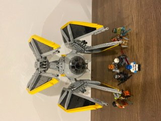

This is a great quality reproduction of arguably the coolest TIE design in Star Wars. I recently completed this model and recoloured it as Vult Skerris' TIE Defender Elite, from the Rebels Season 4 episode Rebel Assault. The construction of the model is, as with all of Jerac's designs, solid and sophisticated. The wings are held in place through a friction technique involving a hollow 4x4 plate and a series of 2x8 plates and other modified plates which is ingenious in my opinion.
The shape of the solar panels is expertly captured, and although there are some gaps between the black sections of the panels and the grey (or in my case yellow) borders, they are hardly noticeable. The model is well balanced and easy to handle and the minifigure pilot fits snugly in Jerac's first decorated TIE cockpit.
I think this was the perfect model to round out your collection of TIE designs, Jerac. I plan on building one of your X-wings in Phoenix squadron colours to accompany the Defender Elite, I'll post another picture here when I do so.
I'd love to see your version of a TIE Phantom, if you're ever wondering what to build next. Rebel Builder on Youtube has a great version built in lego's signature style, but I prefer your SNOT-solar panels.

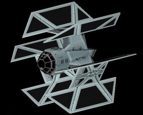

I've always been a fan of the TIE Defender, but I really prefer the depiction by the original creators Totally Games. These guys created the fighter in their game TIE Fighter and then made their most detailed model of it in the sequel X-Wing Alliance.
As you can see, it has elongated struts and rear hull compared to most other depictions of this craft. The only guy I've seen who has faithfully followed along this original vision is Fractalsponge with his CGI model: TIE Defender – Fractalsponge.net
Jerac, do you have any ideas for how I could mod your design to more closely resemble this?
This is a major rework. Panels are completely different, almost symmetrical lengthwise, while mine uses more tie-interceptor like panels.
I'd say it needs to be done from scratch if you wish to have this look like this ship you posted. Really the only common part is the triple-fold symmetry. Even the front is not a ball anymore, but something else.
