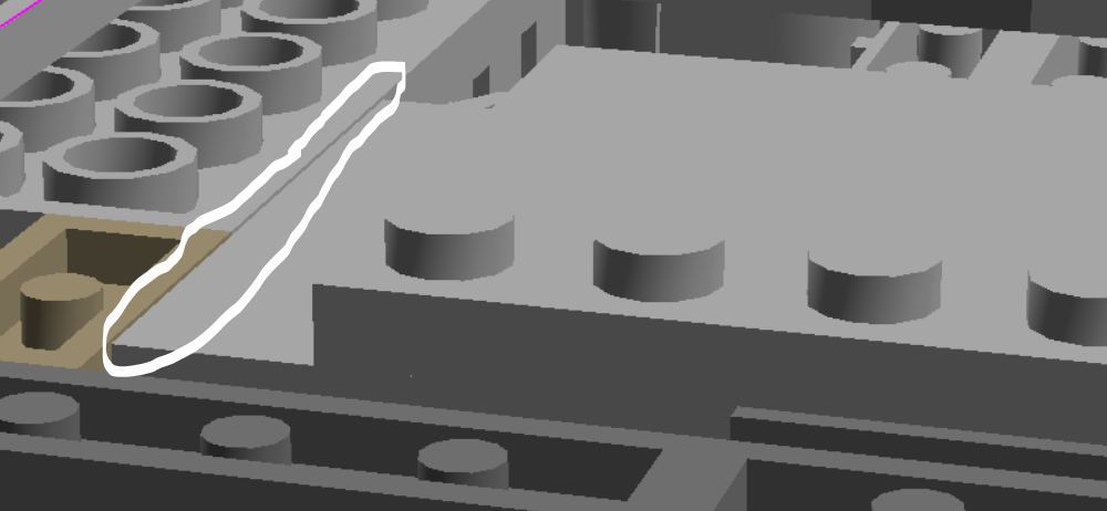

G0d0fninjas12 Posted November 15, 2018 Posted November 15, 2018 (edited) what i do on LDD is look at instruction books and do them in LDD, but i am now stuck. In it, it wants me to have a brick upside down, a brick right-side up, and put them right next to each other so it is flat (the right-side up piece is a flat tile), when ever i do this, there is always a very tiny height difference that makes it hard for me to add the next piece there, is there any way i can do this? Edited November 20, 2018 by G0d0fninjas12 Quote

Calabar Posted November 19, 2018 Posted November 19, 2018 Usually there problems are due to: - use of the wrong bricks as a SNOT, for example technic bricks with pin hole have different measures than standard bricks. - use of some LDD automatic tool (such as hinge tool) that during its use slightly move some brick, creating the disalignment. In this case is necessary to remove the disaligned bricks as soon as possible, because they easily propagate the disaligment to all bricks attached to them. - impossible design: it is not possible to obtain the result in that way, even if thanks to real bricks tolerances is seems possible. Is it an official set? If so, which one? For a better help, you should share the LXF file (or the interesting part of it, at least). PS: please edit topic title (you can do that editing the first post) giving you request a more significative description. With a generic title like this one, it is more difficult to obtain help but, mostly, it will not be helpful for other people with the same problem because impossible to find with search. Quote
G0d0fninjas12 Posted November 20, 2018 Author Posted November 20, 2018 (edited) 21 hours ago, Calabar said: Is it an official set? If so, which one? it is the LEGO® Star Wars 75192 Millennium Falcon set link: https://shop.lego.com/en-AU/Millennium-Falcon-75192 this is what the instructions show Edited November 20, 2018 by Calabar Fixed image not visible Quote
Calabar Posted November 20, 2018 Posted November 20, 2018 (edited) Page/book of the instructions? The image I think you tried to attach is not visible (EDIT: I fixed the image, but a reference to the building instructions would be much more helpful). What about sharing your lxf file? (or part of it, at least) How the reversed plate is connected? Is it possible to fine move it downwards using a scaffolding? The 75192 is a challenging build for an LDD novice. Maybe you already became acquainted with LDD building simpler sets? Edited November 20, 2018 by Calabar Quote
G0d0fninjas12 Posted November 20, 2018 Author Posted November 20, 2018 (edited) 40 minutes ago, Calabar said: What about sharing your lxf file? since i have already used all the attachments i can send (maybe when i rank up i can send more?) this is the link i got it from: http://lego.brickinstructions.com/pdfdrop/75192_1.pdf it is on page 89 and the no. is 167 top left of page (it might take a while to load since it has more than 400 pages :p) i have also tried 2 ways for the scaffolding i saw on youtube but they all equal to this tiny space also when i first used LDD, i made the small x-wing and other ship models, then i made the giant BB-8, now i am trying to do this, which this is getting me stuck, since i need to put something next to it, but that tiny gap makes it hard to Edited November 20, 2018 by G0d0fninjas12 adding more information Quote
Calabar Posted November 20, 2018 Posted November 20, 2018 Ok, Page 89, Step 167. I'll take a look (not so soon, I'm quite busy this week) About sharing files, I suggest you to use a LEGO related hosting such as brickshelf or bricksafe, that are reliable and allow to host both images and lxf files and share that with hotlink. Quote

G0d0fninjas12 Posted November 22, 2018 Author Posted November 22, 2018 On 11/20/2018 at 11:48 PM, SylvainLS said: This should work oh wow it does thank you, i'm going ti save this in case i forget and it happens again Quote
