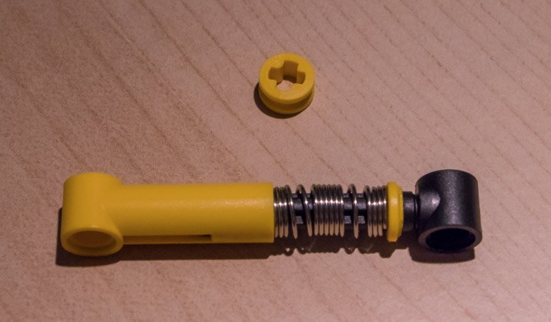

TopLvlObj Posted June 20, 2018 Posted June 20, 2018 One way to fix the front suspension is to add a spacer to the shocks. The spare yellow bushing will work but it will make the shocks too strong. So I ended up cutting the bushing in half and install that on all 4 front shocks And now the front suspension works perfectly. Quote
technic_addict Posted June 20, 2018 Posted June 20, 2018 On 6/20/2018 at 4:45 AM, TopLvlObj said: One way to fix the front suspension is to add a spacer to the shocks. The spare yellow bushing will work but it will make the shocks too strong. So I ended up cutting the bushing in half and install that on all 4 front shocks And now the front suspension works perfectly. Expand Did you try one spring with a half bush and one spring unchanged? Quote
chox Posted June 20, 2018 Posted June 20, 2018 My news mod (inside the Chiron) with only 7 speed : Quote
1963maniac Posted June 20, 2018 Posted June 20, 2018 On 6/20/2018 at 4:45 AM, TopLvlObj said: One way to fix the front suspension is to add a spacer to the shocks. The spare yellow bushing will work but it will make the shocks too strong. So I ended up cutting the bushing in half and install that on all 4 front shocks And now the front suspension works perfectly. Expand Why not use a lighter springed shock absorber and anchor the ends closer together? Quote
