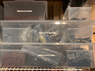

Good evening,
                       This message is for the creator of the UCS Sandcrawler @cavegod but if any body else can help that would be great also!!! Just bought the UCS Sandcrawler plans from Brick Vault and am at 91% of the pieces collected. After studying the instructions inside out I couldn't noticing a lot of discrepancies between the pics I was looking at and the instructions. Such as, but not limited to; where do the battery pac, etc goes. Also some items are not listed in the parts list or just doesn't exist. As I was making research I just happen to discover this thread vie Rebrickable and wow it sure did help with figuring some items missing but am still left with a lot of questions so this is where I hope @cavegod can help me or anyone who have built the Sandcrawler.
Questions (have 'lots and in no particular order...trying not to forget any):
1. Item #44294, Technic, Axle 7L, black x4....very expensive...does it have to be black? If it's you see them and yes they need to be black...ok I'll then buy them if not what colour do you recommend?
2. I notice in the interior that item #3873, Technic, Link Tread, black is not in the part list and or in the building instruction but all the gears are there...can anyone tell how many you need total and per side?
3. Item #24316, Technic, Axle 3L with Stop, Dark Bluish Gray; according to Bricklink doesn't seem to exist...what would you recommend for replacement (item # and colour)?
4. Item #3070b, Tile 1 x 1 with Groove, Tile 1 x 8; Dark Brown; according to Bricklink seem to exist...what would you recommend for replacement (item # and colour)?
5. Item #4172, Tile 1 x 8; Dark Brown; according to Bricklink doesn't seem to exist...what would you recommend for replacement (item # and colour)?
6. Item #2412b, Tile, Modified 1 x 2 Grille with Bottom Groove / Lip; Dark Brown; according to Bricklink doesn't seem to exist...what would you recommend for replacement (item # and colour)?
7. Item #4589, Cone 1 x 1 without Top Groove, Dark Orange; according to Bricklink doesn't seem to exist...what would you recommend for replacement (item # and colour)?
8. Item #4865b, Panel 1 x 2 x 1 with Rounded Corners, Dark Orange; according to Bricklink doesn't seem to exist...what would you recommend for replacement (item # and colour)?
9. Item #32064b, Technic, Brick 1 x 2 with Axle Hole (x Shape), Reddish Brown; according to Bricklink doesn't seem to exist...what would you recommend for replacement (item # and colour)?
10. Item #87513c01, Light Bluish Gray, 9V Battery Box Power Functions (Non-Rechargeable) with Dark Bluish Gray Bottom; how many do you really need and where do go? The instructions that I got from Brick Vault don'T show it.
11. Item #58123bc01, Electric Power Functions Receiver Unit with Dark Bluish Gray Bottom and Black V2 Print (Version 2); where do go? The instructions that I got from Brick Vault don'T show it.
12. I also notice the revamp interior, very nice, is there instructions for that? If, yes where can I get the part list and instructions?
Did send numerous emails to Brick Vault they were somewhat helpful when ever they answered (not trying to be negative here) but they did told me they were working with the maker for a revamp items list/instruction and would get an update when available. If there is such thing can I get it?
 I'm sure along the way but if the maker or anyone can help/guide me that would be great!
Thanks
Erick
