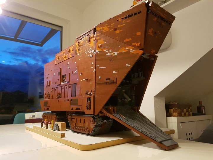

On 6/7/2020 at 5:38 AM, treffer21 said:
done, thank you for this masterpiece!
Your missing some cheese slopes from the front!
In the meantime they are installed. Also the gaps on the side of the roof are filled. I just was so excited when i was finished that i took the fotos. On the next day i took a closer look and found some little mistakes.
Thx for the hint
