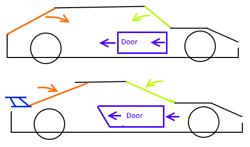

BrickbyBrickTechnic Posted April 10, 2018 Posted April 10, 2018 Your roof is flat and way too long. I would suggest more slope leading up from the rear to it. Quote

BrickbyBrickTechnic Posted May 10, 2018 Posted May 10, 2018 (edited) 33 minutes ago, TechnicRCRacer said: Thanks! How should I change the rear? Right now you have a slope from the top of the roof at the back to the black area. Make the slope longer, so it stretches farther, like to the red panels above your rear lights, kind of like in the Ferrari F40: (I hope the image isn't too big ) Does that help? Edited May 10, 2018 by BrickbyBrickTechnic Quote
TechnicRCRacer Posted May 10, 2018 Author Posted May 10, 2018 1 hour ago, BrickbyBrickTechnic said: Right now you have a slope from the top of the roof at the back to the black area. Make the slope longer, so it stretches farther, like to the red panels above your rear lights, kind of like in the Ferrari F40: (I hope the image isn't too big ) Does that help? Oh, that’s what you meant! Sure thing! Quote
