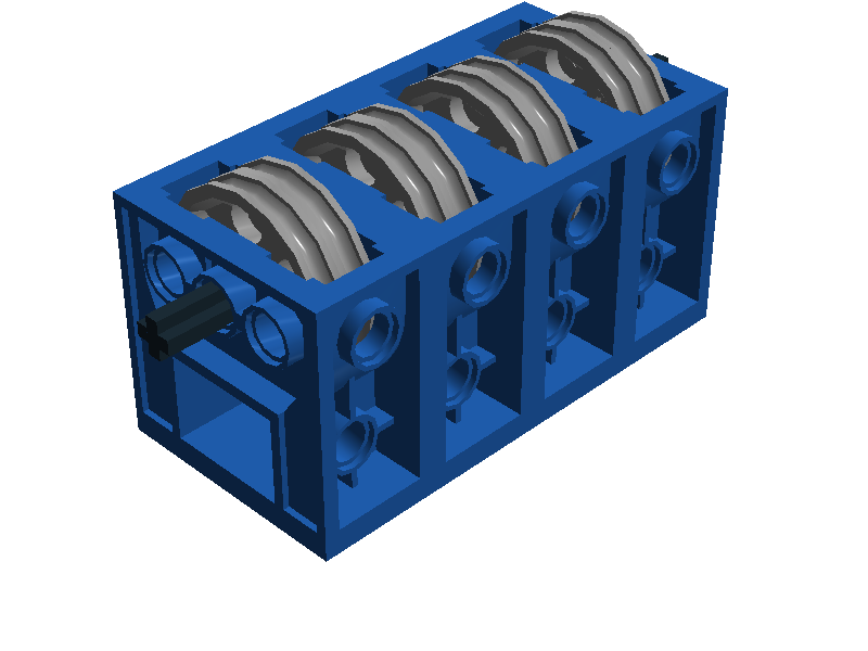

Imanol BB Posted January 5, 2018 Posted January 5, 2018 Hey Tom, i made some experiments in LDD, and made some kind of heavy duty hook, 2 versions actually, the right one uses the cross hole wheels, and each one has its own 2L axle (the red ones in the pictures) for independent rotation (note that the 2 parts with the 1 1/2 pins at the sides are meant to be placed in the 3x5 frame to avoid the 2L axles from displacing and popping out), now, left one uses wheels with pinholes, which means that a single axle can go through all the pulleys and they will still be able to turn at different speeds, here are some pictures: I hope these designs can be inspiring for you, i will try to see if i can think of some improvements, but so far that is what i have achieved. Quote

TomSunny007 Posted January 6, 2018 Author Posted January 6, 2018 On 1/5/2018 at 12:18 AM, Imanol BB said: Hey Tom, i made some experiments in LDD, and made some kind of heavy duty hook, 2 versions actually, the right one uses the cross hole wheels, and each one has its own 2L axle (the red ones in the pictures) for independent rotation (note that the 2 parts with the 1 1/2 pins at the sides are meant to be placed in the 3x5 frame to avoid the 2L axles from displacing and popping out), now, left one uses wheels with pinholes, which means that a single axle can go through all the pulleys and they will still be able to turn at different speeds, here are some pictures: Expand Thanks for all the effort. To me the left one with a single axle feels the most promising. I fear those short 2L axles will pop out of the holes when all that heavy load starts to bend and twist parts. The use of 3x5 frame is very good. Those liftarms may be the weak point as in my video 2 liftarms were able to hold only 30 kg. The pins are also a question mark how well they withstand load. Anyway, this looks so good I'll probably try it sometime. :) On 1/5/2018 at 8:58 AM, Doug72 said: For a six fold purchase to raise and lower a heavy bucket chain excavator boom I used these. They have a deeper groove than wedge wheels and keeps the cord in place better. They come in two versions:- LEGO Rim Narrow Ø18 x 7 and Pin Hole with Shallow Spokes (56902) LEGO Rim, Narrow Ø30 x 14 with Axle Hole (56904) Expand Thanks. That 56902 looks perfect. Another pin holed small wheel I found is 30155 but it doesn't have that nice groove for cord. On 1/5/2018 at 9:00 AM, Philo said: I made that kind of experiments a long time ago for a mindstorms contest: http://philohome.com/hoist/hoist.htm Expand Not bad. 44 kg and probably a lot more. Funny how you used exactly the same configuration as I: 4-fold purchase and 15:1 gear ratio, at least in one of the pictures. On 1/5/2018 at 6:15 AM, Aleh said: All these experiments brakes parts so don't be fond of them too much. Expand Well, this is a dilemma for me. I will brake more parts if I continue making these kind of experiments. Next I have been thinking about measuring Lego axle breaking/deformation point. Certainly some viewers will feel bad for those destroyed and mishandled Lego pieces. That's not the way they are supposed to be used. But also, I think many find the engineering and science behind these experiments interesting and useful. You can learn something from them. And then some viewers just have fun seeing things blow up. I guess I will just go on breaking parts and see what kind of feedback I get. Quote
TomSunny007 Posted July 28, 2018 Author Posted July 28, 2018 Imanol BB Do you mind if I show your hook design images (and one of your comments) on a new video? I tested the design and it works great. :) Tried to contact you on your yahoo email. I'm not yet allowed to send private messages on Eurobricks. Quote

Imanol BB Posted July 28, 2018 Posted July 28, 2018 On 7/28/2018 at 8:51 AM, TomSunny007 said: Imanol BB Do you mind if I show your hook design images (and one of your comments) on a new video? I tested the design and it works great. :) Tried to contact you on your yahoo email. I'm not yet allowed to send private messages on Eurobricks. Expand Of course, you can use them without any problem, i'm glad the design was a success, i hope to see it in action in the video. Quote
TomSunny007 Posted July 28, 2018 Author Posted July 28, 2018 Here is a new video testing Imanol's hook design, 56902 pulley wheels, and multiple points for pulling string. Feel free to comment. I'm currently wondering if there is any point in going further. Quote

Imanol BB Posted July 29, 2018 Posted July 29, 2018 Well, i must say i'm impressed, never thought that the hook would take that much weight before breaking, really amazing experiment. Quote
