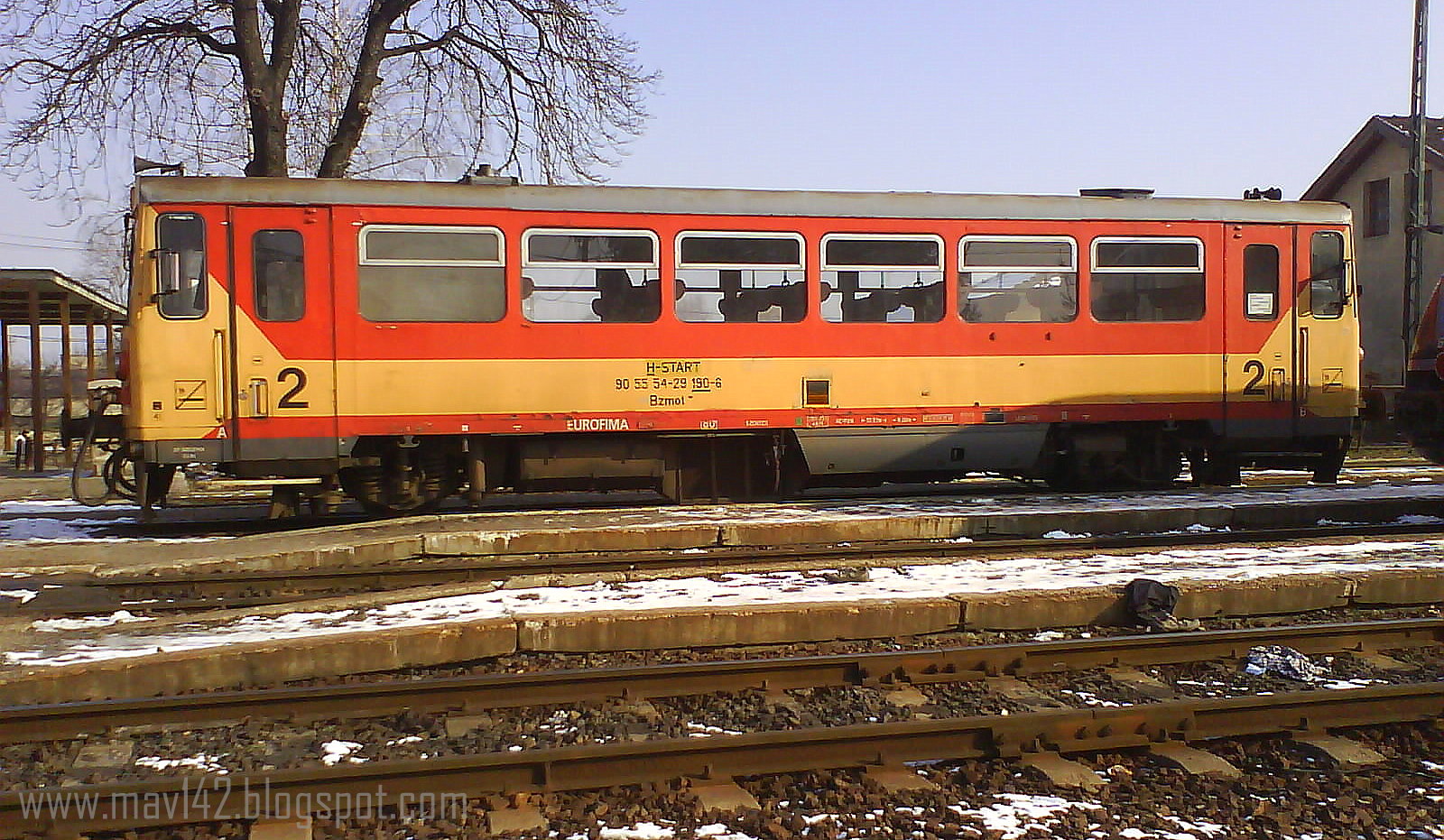

I built a Lego train and it has a 2-wheel bogie. If the train enters into a straight section from a curve the bogie doesn't turn back. Also, another problem is that the in a straight section I can move the bogie freely.
I can't use 4-wheeled bogies, because the train that I built doesn't have that bogie in real life.

@SwengX Oh blimey!! And I thought it was only us Brits who were crazy enough to come up with a self-propelled 4-wheel railcar. *huh*
If the idea is to run that as a single car and not as part of a larger consist then even castoring is unlikely to help, because at least the leading axle will need to be lead through a curve in order to impart steering impetus.
@Toastie SwengX doesn't appear to have set up his MOC to take advantage of castoring because it appears that his axle pivot is directly on top of the axle itself. For that you need to move the pivot point away from the axle, in the manner of the supermarket trolley wheel. Apart from that there are few similarities between the dynamics of trains and supermarket trolleys, I agree.
