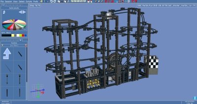

i have been working on this in ldcad for anyone who wants to build it

hello folks - I know to make instructions from a LDCad file via LPub(3D) or Stud.io. However it is a lot of work and will consume some time. But if I can have a closer look on the LDCad file I can check how much work it would be. So If 9v System would share his file ...

I nearly finished based on Dunes "flat file" a model build in LDCad wich has suitable submodels to create a LEGO-like instruction.
Last pice I am missing is the lenght of the rigid hoses used as ball rails. I tried to "look up" them in the pictures and videos, but I finally failed :-(
I'll try to get in contact with Berthil if he can hopefully remember the individual lenght of the used hoses.
With this Information I can finalize the parts list also.
stay tuned :-)
@SWL I used 42 pieces of 32L 3mm rigid hoses as they were the cheapest to get through bricklink at that time. That's almost 5,5 meter.

I finished the model in LDCad including submodels suitable to create sub-steps & sub-models in the instruction, which I will start now.
