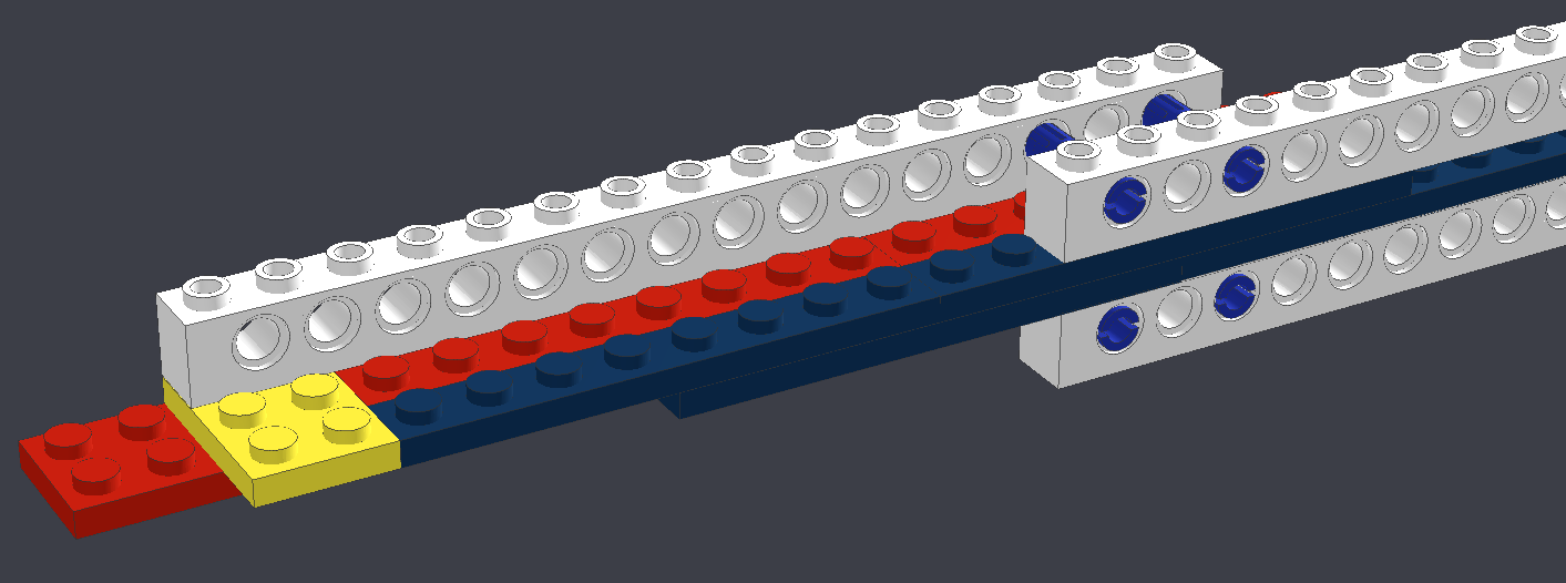

Davidz90 Posted August 7, 2017 Author Posted August 7, 2017 (edited) Thanks guys!! BTW are there any tehniques to make a stiffer guitar neck, or generally strong technic beam? I have 4x8 plates near the body and then 2x8 plates and 1x8 plates sandwiched between technic bricks, with ocasional 2x3 plate to connect them, making some sort of a H-beam (see image). What could I do, apart from using longer plates and bricks? Edited August 7, 2017 by Davidz90 Added image Quote
Davidz90 Posted August 24, 2017 Author Posted August 24, 2017 On 8.08.2017 at 0:05 AM, kieran said: Lots of old black friction pins may help Thanks, that worked quite well! After some stiffening (and running out of black pins :D), I could actually tune it better and try something more difficult. This is the result: Quote
