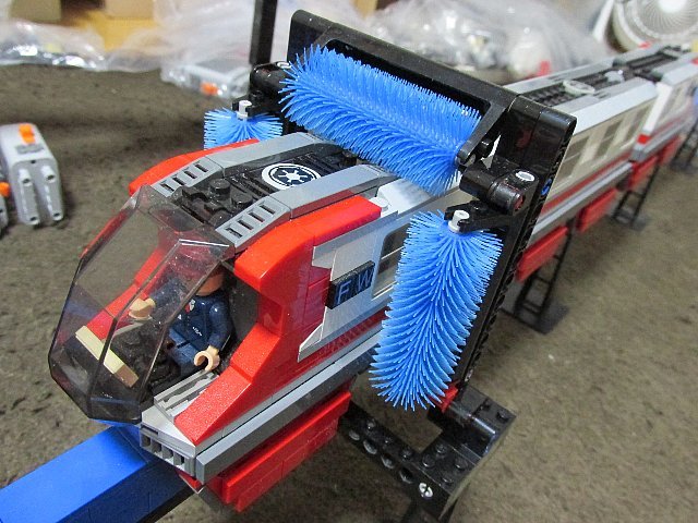

Masao Hidaka Posted November 22, 2018 Posted November 22, 2018 Hello everyone! Just now, I got this account! :) Quote
sed6 Posted November 22, 2018 Posted November 22, 2018 56 minutes ago, Masao Hidaka said: Hello everyone! Just now, I got this account! :) Hello! Welcome! Thanks for joining Eurobricks and saying hello in this thread. You have probably noticed that your great monorail work is admired by a lot of people in this thread. Please feel free to show us any new or existing projects you're working on. I like the monorail wash station in your picture. Quote
