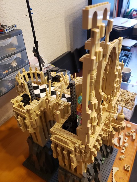

Davidz90 Posted July 16, 2025 Author Posted July 16, 2025 Recently I bought the Notre Dame cathedral set and noticed how good value per piece it has (granted, most of the pieces are rather small). I already had a substantial collection of tan pieces thanks to my clock tower that I wanted to improve. So, one irresponsible financial decision later: Armed with that (and a few separate brick orders), I have started a truly grand project. This clock tower will be more like an actual building, standing on a cliff. I want to strike a balance between a tower and a cathedral. The spike on the "balcony" at the front will point to identical spike at the end of the pendulum. This will be an easy way to make sure that the tower is leveled properly. In addition to a working clock mechanism, the tower will also have lights. Here's a sneak peek at the electrical system and initial tests The complete tower will be about 170 cm high. This is the lowest (and most massive) of three sections it will divide into for easy moving. Two weeks of building so far, this is gonna be a loong project. Quote

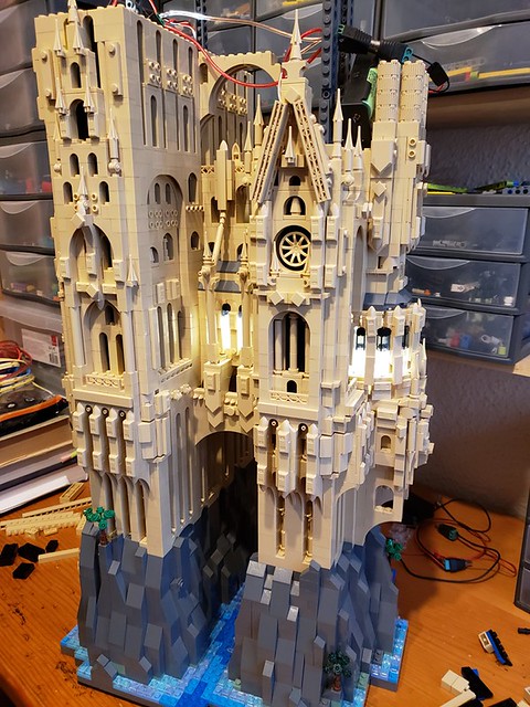

Davidz90 Posted August 3, 2025 Author Posted August 3, 2025 It's alive! Finally got to the clock part of this build. Pendulum (well, ugly placeholder) hangs in front, escapement is powered by two weights hanging in the recesses of the H-shaped structure of the tower. Quote
Davidz90 Posted August 11, 2025 Author Posted August 11, 2025 It's done. That was a lot of work. Quote
