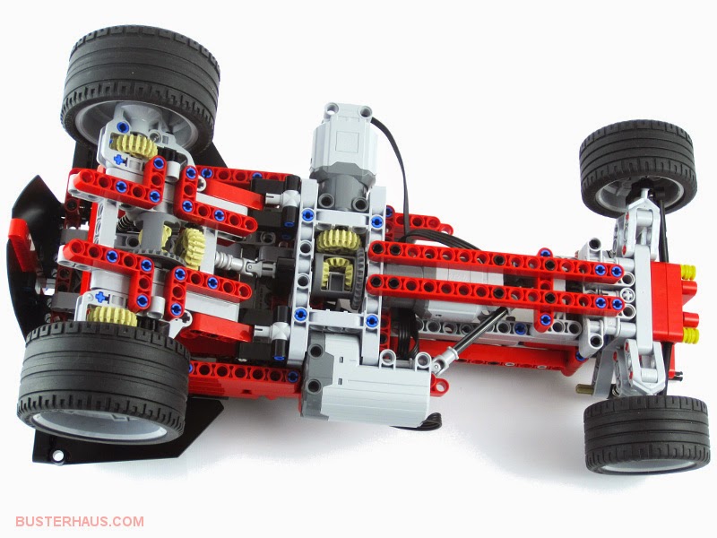

BusterHaus Posted April 23, 2017 Posted April 23, 2017 I used an adder in one of my early builds. It used two L motors but would work with any combination of motors. Quote
Void_S Posted April 23, 2017 Posted April 23, 2017 32 minutes ago, BusterHaus said: I used an adder in one of my early builds. It used two L motors but would work with any combination of motors. It's a very unusual assembly... I'd suppose that initially it was two L motors with no adder and with servo right behind the front axle Quote
