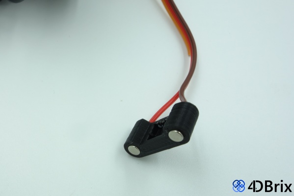

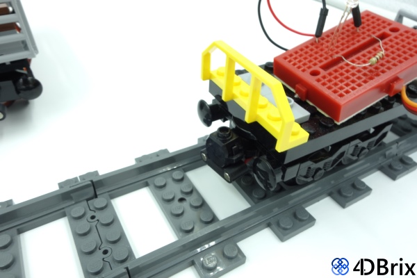

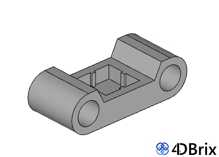

When I discovered this thread I couldn't resist giving this a try with 3D printing.  The solution of @igordost is very neat but I agree with @TCRR Constitution that ideally it should not require any modification of the original LEGO coupling.  Luckily LEGO added a stud at the bottom of the coupling.  I had some 3mm magnets in stock so I designed a small brick that you can stick on the stud of the coupling and that can hold 2 magnets.
I made a couple of prints to fine tune the dimensions.  I added the magnets and wires:
and snapped it on the train coupling
It seems to work perfectly!  I made a little video.  The car on the left has the battery, the car on the right has an LED.  When you connect the cars, you connect the LED to the battery and it lights up...
Any thoughts, comments ?

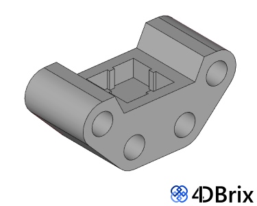

Looks good. Is it possible to attach two of the parts to one coupler to have four wires (required for data transfer like I²C)?
Thanks!
Yes, putting a second one on top of the coupling seems to be possible.  It does start looking quite bulky though...
For the power + data connection I was thinking about getting some magnets that are slightly smaller (2mm diameter instead of 3mm) and arranging them like this:
That would be a lot more elegant than using 2 connectors with 2 magnets.  My only worry is the alignment of the magnets.  2 magnets will always make contact, with 4 they will have to be flush enough to make the electrical connection...  I'll give it a try!
